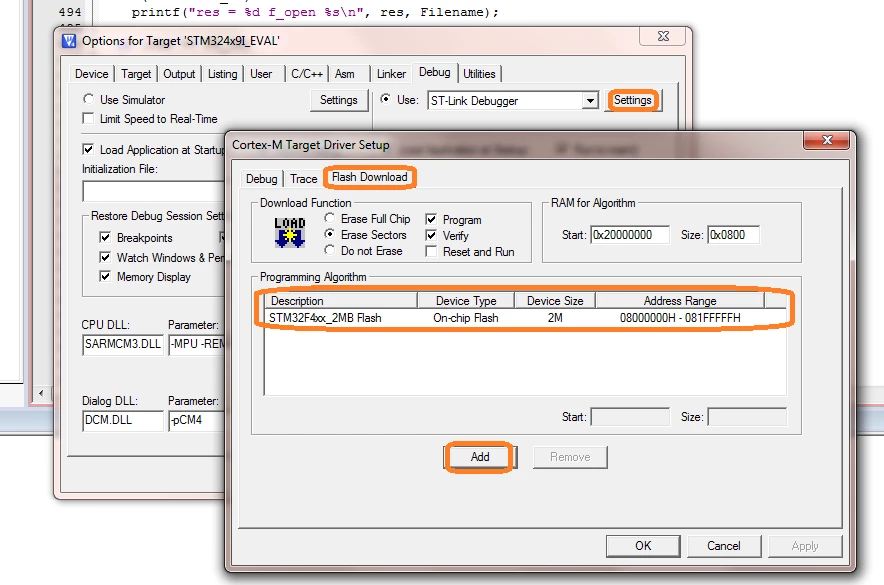

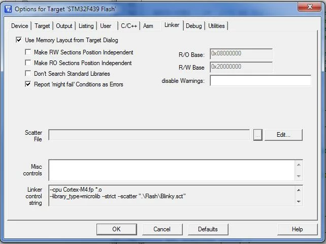

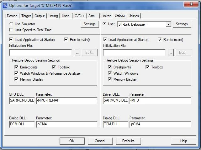

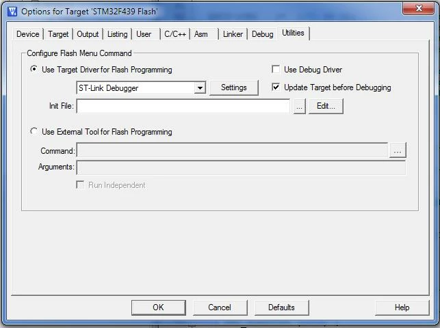

How do I know if it's 2M algorithm or 2x1M? Sorry about the novice question. I came from TI/CCS environment. Not too familiar with this.
Following is the error message.
Load ''C:\\Keil\\ARM\\Boards\\ST\\STM324x9I-EVAL\\Blinky\\Flash\\Blinky.axf''
No Algorithm found for: 08000000H - 08000E53H
Erase skipped!
and pop up a windows with
''Error:Flash Download failed - ''Cortex-M4''
I use embedded ST-Link.

Tesla DeLorean
Guru
Jul 15, 2013 9:42 PM UTC
Posted on July 15, 2013 at 23:42
tonyyu
tonyyuAuthor
Jul 15, 2013 10:38 PM UTC
Posted on July 16, 2013 at 00:38
many, many thanks.
problem solved.
