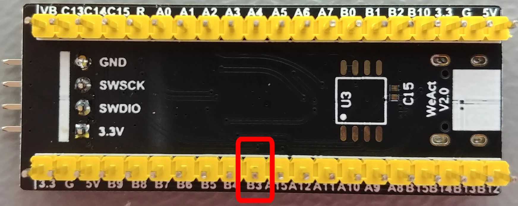

Blackpill STM32F411CU6 lacking SWO Pin in SWD header => no SWV ITM printf ?
All clock setup and tracing enable checkbox checked and port0 selected but still no SWO printf debug messages in CubeIDE debugger.  Further research led to the SWO pin function (PB3) that deliveres the trace data from the board to the debugger. However Blackpill's SWD header only has four pins GND,Vcc,CLK,DIO, enough for firmware flashing, manual memory inspection but I fear not for SWO tracing .
Is my "analysis" correct, that the stock SWD header is per design not capable of SWO tracing?

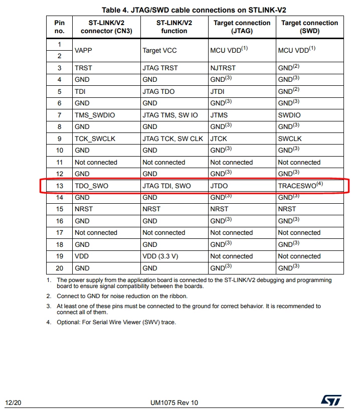

ST-Link V2 only offers one additional pin (besides NRST) named SWIM on its 10-pin connector.
I assume that is not where PB3 ought be connected to, correct?

For https://stm32-base.org/boards/STM32F411CEU6-WeAct-Black-Pill-V2.0.html you can access SWO (JTDO)  as PB3 Header 2 pin 11. Or consider RTT.

Note that the Black (and other-coloured) Pills are not ST products, and are likely to have fake (non-ST) chips fitted.
Yes but, as @Uwe Bonnes said, there's nothing to stop you accessing PB3 (and, thus, SWO) via other headers on the board.
That's a fake (aka "clone") ST-Link, then:
https://community.st.com/t5/stm32-mcus/how-to-recognize-a-genuine-st-link-v2-versus-a-cloned-one/tac-p/703663/highlight/true#M965
A genuine ST-Link V2 has a 20-pin connector, and does include SWO:
https://www.st.com/en/development-tools/st-link-v2.html
https://www.st.com/resource/en/user_manual/um1075-stlinkv2-incircuit-debuggerprogrammer-for-stm8-and-stm32-stmicroelectronics.pdf#page=12

Yeehaw! with a soap box ST-Link (NOT the tiny aluminum cased ST_Link ripoffs)
one can connect BP3 (JTDO) to the TDO pin (pin13) on the St-Link and
voilá beautiful debug output, directly in CubeIDE!
