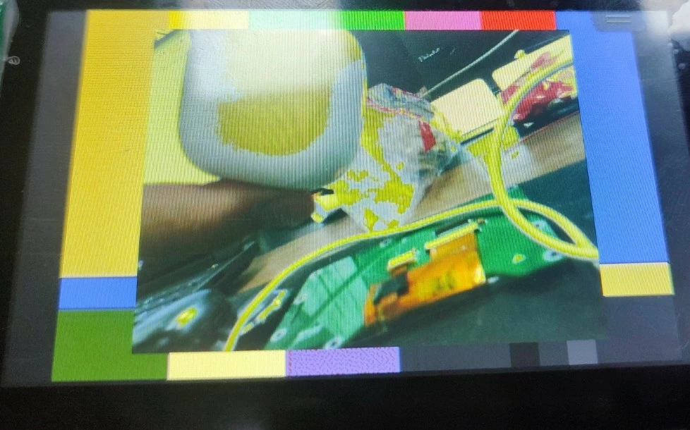

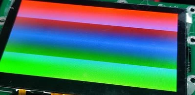

Hello everyone,
I am currently migrating a project from a Newhaven ATXL series display to their newer ASXP series (both 4.3", 480x272 RGB interface) on a custom board based on the STM32F767.
I am trying to isolate the root cause of severe color artifacts I'm seeing, specifically whether this is a Software configuration issue, a signal integrity issue on my Custom PCB, or a potential hardware defect in the display panels I received.
The Situation: I have configured the LTDC timings strictly according to the new ASXP datasheet. However, the image is unstable and has artifacts.
The "Hot-Swap" Verification: To troubleshoot, I performed a live test to rule out my PCB connections:
  1. I initialized the STM32F767 with the new ASXP LTDC settings.
  2. Connected the new ASXP screen -> Result: Artifacts/Noise.
  3. While powered on, I swapped it with the old ATXL screen.
  4. Result: The old ATXL screen works perfectly even when driven with the new ASXP timings.
Video of the test:
My Question: Since the old screen works fine with the new settings on the same PCB, I am confused about the source of the failure with the new screen.
  • Software: Is the ASXP series significantly more sensitive to DCLK Polarity or Drive Strength than the ATXL?
  • Hardware (PCB): Could my custom PCB design be marginal for the newer ASXP controller?
  • Defect: Given that the settings work on the old screen but fail on the new one, is it possible that these specific ASXP units are defective?
Has anyone experienced a case where a newer panel is this much more sensitive to signal quality, or should I suspect a bad batch of displays?
Any advice to help me pinpoint the culprit would be appreciated.
Thanks.

I am writing to update this thread and mark the issue as SOLVED.
It turns out the issue was not related to the Display Panel compatibility, LTDC Timings, or the PCB Design. The root cause was a manufacturing defect (Cold Solder Joint) on the Board-to-Board (BTB) connector of the specific PCB unit I was using for testing.
The Troubleshooting Trap (The "Bad Luck" Scenario): We have a batch of 10 identical PCBs assembled by a third-party.
  1. By chance, the specific unit I picked from the batch to test the new ASXP screen happened to have a soldering defect on the BTB connector.
  2. When the screen showed artifacts, I naturally blamed the new display settings/compatibility, assuming the PCB was fine since it was fresh from production.
  3. The old ATXL screens were never mounted on this specific faulty unit, so we had no baseline comparison for this specific board.
The Solution: The breakthrough happened when we decided to try the new ASXP screen on a second PCB unit from the exact same batch. It worked immediately with standard datasheet settings.
Returning to the first "faulty" PCB, we inspected the BTB connector, applied flux, and reflowed the pins. The artifacts disappeared, and the unit is now working perfectly.
Lesson Learned: When testing a new component on a new batch of PCBs, never rely on a single unit. A manufacturing defect on your "test mule" can easily mislead you into debugging software for days. Always cross-check with a second board!
