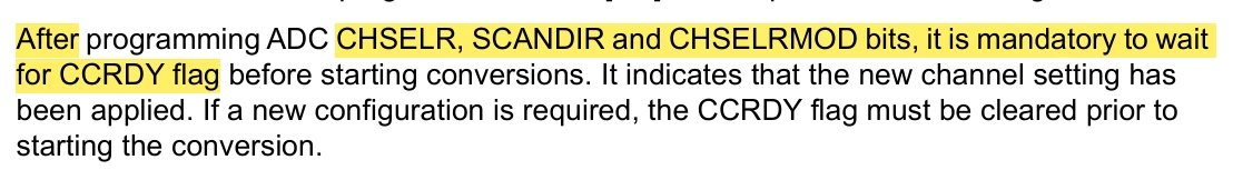

Hi all,
I am trying to understand the relationship between CCRDY and CHSELR. Unfortunately, there is a bit of bad grammar in the Reference Manual on this subject, which is not helping...
The manual seems to say (and some examples support this) the sequence is -
ADC1->ISR |= ADC_ISR_CCRDY
ADC1->CHSELR = adc_channel;
while((ADC1->ISR & ADC_ISR_CCRDY) != ADC_ISR_CCRDY) {};
ADC1->CR |= ADC_CR_ADSTART; // Start the converstion
This sequence doesn't make sense. What would happen if there was an interrupt between clearing the CCRDY and writing the CHSELR?
Can anyone explain the internal workings of the ADC on this topic?
Code seems okay to me, except to clear CCRDY, write 1 to only that bit. Don't read-modify-write as that may clear other flags as well.
CCRDY only gets set when new channel settings are applied. Won't get a CCRDY interrupt before that, if that was the concern.
(I edited this reply, original was incorrect.)

BTW, there is a bug in the LL version of MX_ADC_Init() - it exits with the CHRDY flag reset!
A work around is
MX_ADC_Init();
ADC->CHSELR = ADC->CHSELR; //fingers crossed that your optimiser dosn't remove this
... now wait for the CHRDY flag to go high
