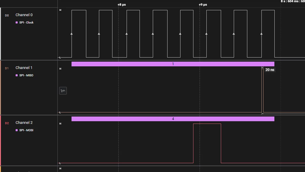

My application is as follows:
The two boards communicate via SPI.
Every two seconds the master boards send a uint8 message to the slave.
Upon receiving the message, the slave board shall light up some LEDs depending on the sent message.
This is a snippet of the code flashed to the slave board:
while (FOREVER)
// When you receive a message from
if (HAL_SPI_Receive(&hspi1, &u8SpiMsg, U16_NUM_BYTES, HAL_MAX_DELAY) == HAL_OK)
// Set/Reset corresponding LED pins via their control bits in BSRR register
GPIOE->BSRR = ...........;
This is the configuration of the SPI:
Mode - Full-Duplex Master/Slave
Hardware NSS Signal - Hardware NSS Input Signal
Frame Format - Motorola
Data Size - 8 bit
First Bit - MSB First
Prescaler (for Baud Rate) - 8
Clock Polarity - low
Clock Phase - 1 Edge
CRC Calculation - disable
NSSP Mode - Disable

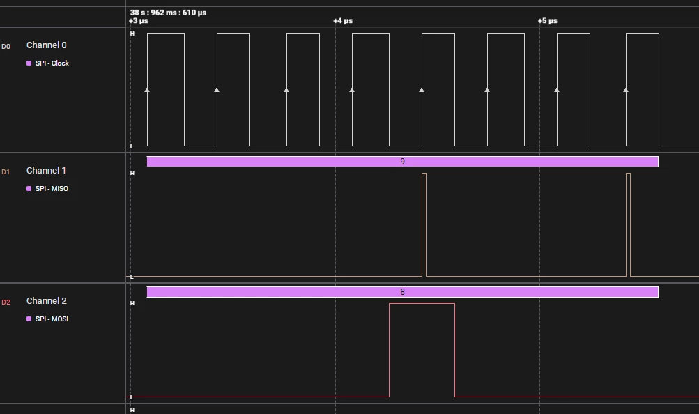

The application works, but when I hooked up a logic analyser (saleae logic to inspect the SPI communication, I saw that the MISO line is not always idle.
Some pulses of 20ns are observed on the MISO line whenever the slave sends a message, as shown in the following screenshots:
I don't understand why the MISO isn't idle when the slave is not sending anything? What is causing the 20ns pulses ?
AScha.3
AScha.3Best answer
Aug 22, 2026 5:03 PM UTC
probably you see just an artifact from capacitive coupling clk -> miso , as your "spike" is exactly at the rising edge of the clock.
So have better isolation of the lines to reduce the crosstalk .
And use a high speed scope to see the real crosstalk/pulses - if you like .
A simple logic analyzer connected with unscreened signal wires is not useful for assessing conduction/crosstalk effects.

Andrew Neil
Aug 22, 2026 5:07 PM UTC
@AScha.3  wrote:
se a high speed scope to see the real crosstalk/pulses.
Absolutely!
@melek_g  you always need to use a 'scope first to confirm that the signal is good & clean.
If the signal is not clean, a logic analyser will give misleading results ...
#ScopeFirst #ScopeThenLogicAnalyser
melek_gAuthor
Aug 22, 2026 5:09 PM UTC
Unfortunately, I don't have a scope in the lab yet.
But thanks a lot for the advice. I'll definitely do that when I get one!
