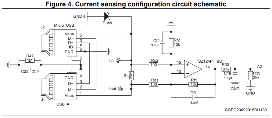

Refer to the current sensing configuration circuit schematic:
The output voltage of the operational amplifier is proportional to the measured current:
