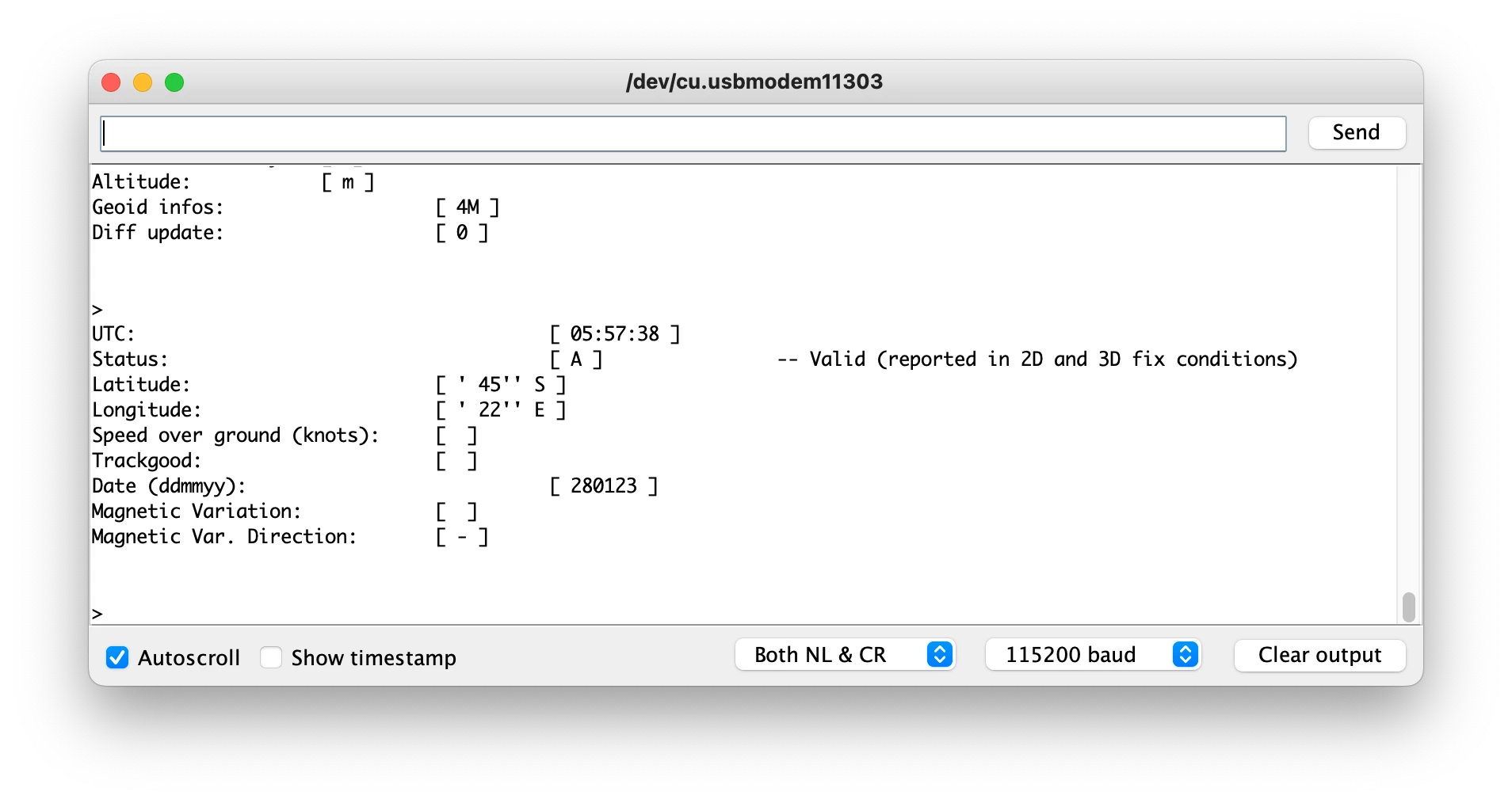

I'm using ST's X-CUBE-GNSS1 software pack but it only prints the minute part of my location coordinate

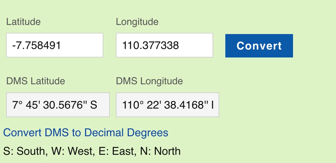

0693W00000Y9O1WQAV.pngCompared with the actual coordinate that shows the degree and seconds part

How do I print the other two components of the coordinate?

    You probably don't have enabled printing of float. Search this forum or internet (-u _printf_float).

    Woops! totally forgot about that. Thanks!
