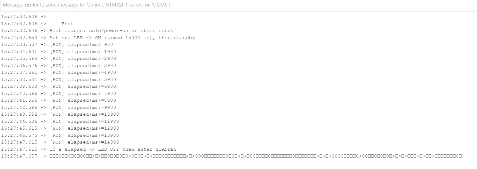

With the same firmware and library versions, I am observing different behaviour on two PCBs that:
  • Have identical schematics
  • Are manufactured by the same vendor
Observed Behavior
  • Without Standby mode implemented, both PCBs behave correctly.
  • With Standby mode enabled:
    • Serial prints before entering Standby appear correctly.
    • After waking from Standby:

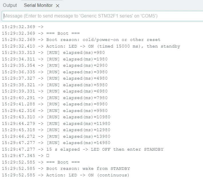

      • One PCB works as expected.

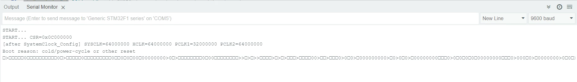

      • The other PCB shows:
        • Garbage characters in the Serial Monitor
        • Significantly extended timing
          • Example: a programmed delay(30 seconds) takes approximately 1 minute 10 seconds
          • All timing sources (delay(), millis(), etc.) appear slowed down

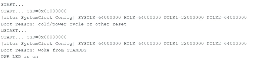

  • Clock information (SystemCoreClock, RCC registers) is printed after reset.
  • From the serial output:
    • Clocks appear correct after a power-cycle reset
    • Clocks appear to be incorrect or degraded after waking from Standby on the problematic PCB

  • Case 1 – Problematic PCB
    • Serial output contains garbage after Standby wake-up
    • All timing functions run slower than expected
  • Case 2 – Proper PCB
    • Serial output and timing behave correctly

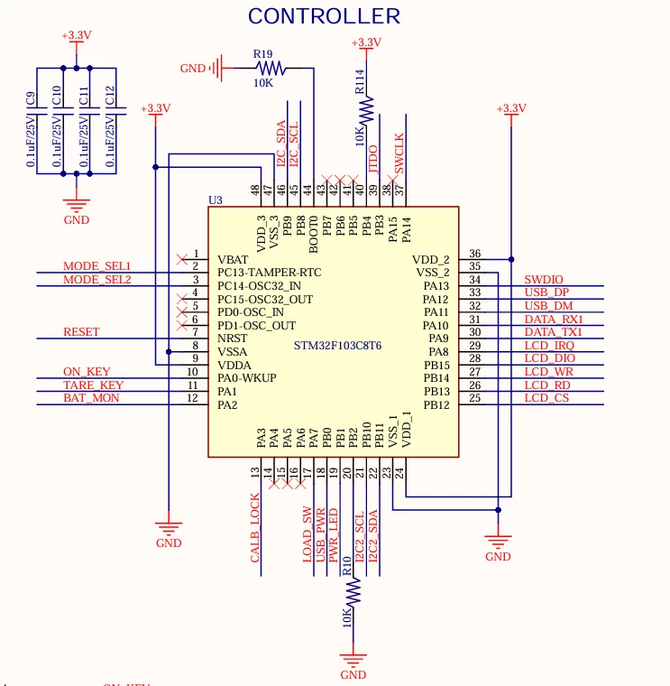

I have also included schematic diagrams for the power and controller circuits
Shanmugapriya_2-1770483300040.png    Shanmugapriya_3-1770483305630.pngShanmugapriya_4-1770483317801.png
Why would two PCBs with the same schematic and firmware exhibit different clock behavior after exiting Standby mode, leading to timing issues on one board?

Which STM32F103 are you really talking about?
In your last posts and now you mentioned the STM32F103CB, but in the schematics you have a STM32F103C8T6. If it really is the STM32F103C8T6, I suggest you first check whether it is an original – the STM32F103C8T6 is counterfeited in large quantities in Asia, sometimes with fake labelling to make it look like the original product.
There have been numerous posts on this topic in the community for years. Suitable search terms are "Blue Pill" or "Bluepill", "STM32F103C8T6", "fake" or "counterfeit".
If you have been duped by a counterfeit, you should either contact the counterfeiter or purchase an original device from an authorised dealer – Alibaba and similar sites are not authorised ones.
