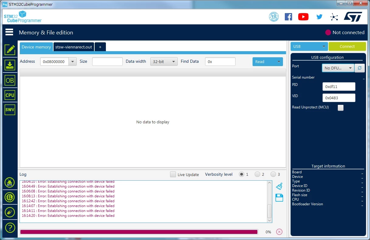

    HKOBA.1
    HKOBA.1Author
    July 30, 2021
    thank you for your answer.
    I connected the PC and STEVAL-ISA164V1 directly via USB, but as shown in the attached photo, "Establishing connection with device failed" is displayed and I cannot connect. Can you tell what is the cause?
    Peter BENSCH
    July 30, 2021
    As the program name suggests, the STM32CubeProgrammer is for STM32 and not for STNRG388A.
    Did you read UM2203?
    Regards
    /Peter
