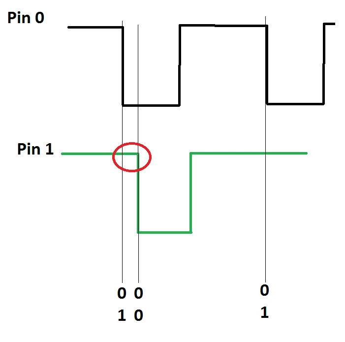

Hello everybody,
how can I count which pin triggers an interrupt, but not multiple times? I have written the following ISR.
INTERRUPT_HANDLER(EXTI_PORTB_IRQHandler, 4)
	data = (uint8_t)GPIOB->IDR& 0xF;
	if((GPIO_PIN_0 & data )== GPIO_PIN_0) {
		counter_Pin0++;
	if((GPIO_PIN_1 & data )== GPIO_PIN_1) {
		counter_Pin1++;
I first store the first four bits from GPIOB port in data and then I mask the bit form the pin. But as you can see in the picture, it is also counted when Pin 1 triggers an interrupt. The sensors have a small delay to each other, but are LOW for a certain time. I actually have 4 sensors, each of which are sometimes LOW at the same time, but trigger an interrupt at different times. Then I do not count 4 interrupts at Pin0 but 11 for example.0693W00000FAFeGQAX.pngBest Regards

    I have helped myself with this function. Since the interrupts are never triggered at the same time in my application, but only one after the other, I helped myself with an XOR and saving the old value. But I still had sometimes not correct results.
     /* In order to detect unexpected events during development,
     it is recommended to set a breakpoint on the following instruction.
     hall1 = (uint8_t)GPIOB->IDR& 0xF;
     switch(hall1^hall_alt) //
     case 0x1: h1_counter++; break; // Pin0
     case 0x2: h2_counter++; break; // Pin1
     case 0x4: h3_counter++; break; // Pin2
     case 0x8: h4_counter++; break; // Pin3
     default: break;
     counter_IT++; // ISR Counter nur zu Testzwecken
     hall_alt = hall1; // alter Wert wird gespeichert
    Maybe you have a better solution? To be honest, it is not relevant anymore, but good to know how to do it for the future.

    There could be several reasons for the problem, but it seems to me that the interrupts are arriving faster than they can be processed?
    Without more detailed information on the clock frequency, interrupt priorities and the settings of the interrupt controller, as well as other interrupt sources, it will be difficult to find a better answer than your workaround you've already found.

    I have built a kind of encoder with Hall sensors as you can see in the picture in the attachment. But the interrupts from the Hall sensors do not trigger simultaneously as you may see in the picture.
    The MCU runs with 16 MHz and I have added the interrupt vector with the priorities. I have modify the lin_slave_app from the ST LIN example 5.1.

    I think your function with xor-ing the current value with the old one is not really correct. You can still have more than1 bit change it's level until you read the new values, so I would do the following:
    change = hall1 ^ hall_alt;
    if (change & 0x01) {
    // pin0 toggle
    if (change & 0x02) {
    // pin1 toggle
    if (change & 0x04) {
    // pin2 toggle
    if (change & 0x08) {
    // pin3 toggle
    This way you catch changes on multiple pins.
