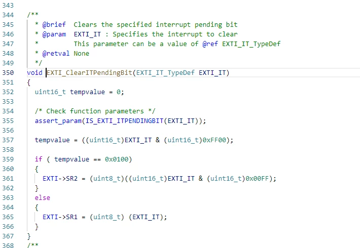

what is the meaning of "EXT_IT_pin7" in the stm8l1526 discovery board?

    The schematic and description of the STM8L-DISOVERY do not contain this identifier.
    Where did you find it?

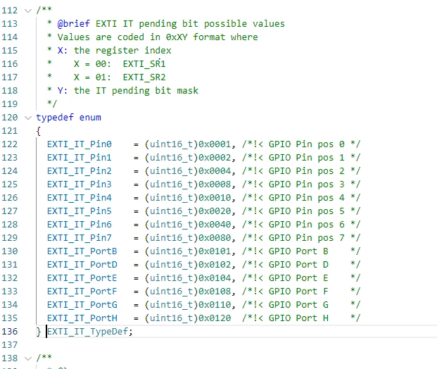

    In these pictures, you can see the function named 'EXTI_ClearITPendingBit'. In that function the argument is EXT_IT_Pin7.
    This function can be found in "stm8l15x_exti.c".
