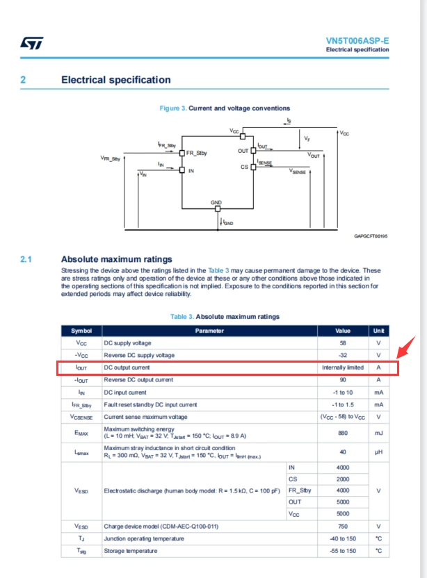

What are the actual allowable currents for VN5T006ASP-E and VND5T016ASP-E?
  • July 19, 2023
  • 0 replies
  • 1093 views
Hi Experts.
I have a project that requires a circuit design using VN5T006ASP-E and VND5T016ASP-E. The temperature of use is -40°C to 85°C. The VN5T006ASP-E needs to pass a continuous current of 10A, and the VND5T016ASP-E needs to pass a current of 5A on each of the two channels, can this be achieved? As shown in the figure below, the manual does not give a specific labeling of how much current can be passed.What is the maximum current that can be passed by VN5T006ASP-E and VND5T016ASP-E? Thanks.
