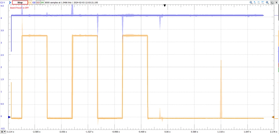

I purchased several of the SMT818 chips and was testing its watchdog timer capabilities for my TI MCU. I started with an input pulse that the MCU sent every 500 ms from a 3.3V GPIO pin into the WDI input. Looking at both this input pulse and the NRST output, I observed that the NRST output stayed high but when I removed this input pulse, the NRST output still remained high and did not attempt to reset like it should have, shown below: (blue signal is the NRST signal and yellow is the WDI signal)

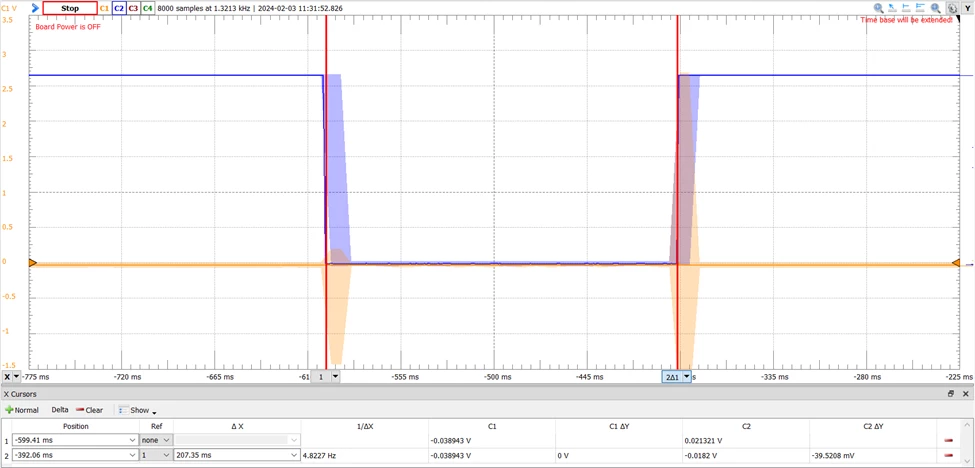

I then lowered the input pulse to 31.25 ns which is the fastest my MCU can trigger. This is where the behavior got strange. Instead of remaining high when the WDI signal triggered, the NRST signal started periodically going low for roughly 200ms shown below. When I removed the 31.25ns WDI input, the NRST signal stopped triggering and remained high.
How exactly did you remove it?
If the pin is floating, it will not trigger the watchdog. If you tie it to GND or VDD, it should trigger.

Pulses need to be at least 50 ns, explains the second result.

hoatsosaAuthor
Feb 5, 2024 4:50 PM UTC
Thank you so much! That was it.
