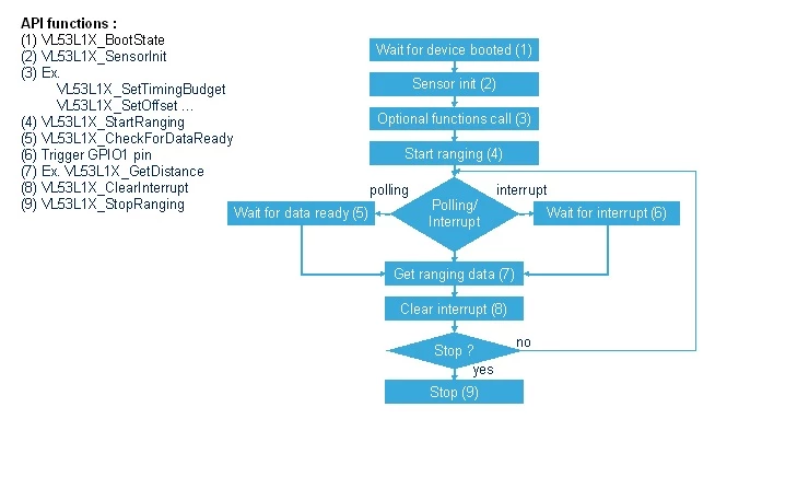

Then I mounted one of the same two VL53L1X-SATEL sensors by interfacing it with the STM8S MCU, using the "VL53L1X ULD API" application package, but here I still have a basic problem that I can't explain.
Before sending the FW used, based on the following flow:
0693W00000Kc552QAB.jpgI would like to briefly describe the defect found in the "VL53L1X_GetInterruptPolarity" function, called within "VL53L1X_CheckForDataReady", in turn called within "VL53L1X_SensorInit".

Not entirely sure, but the following worked for us.
The issue was probably with the power drawn by the module. Had to ensure that the VDD was connected to 3.3V supply with enough capacity for 20mA+ current draw.
We had earlier tried to power it off a GPIO pin of the microcontroller and every-time we did that, it did not work and gave dataReady ==0 all the time.
