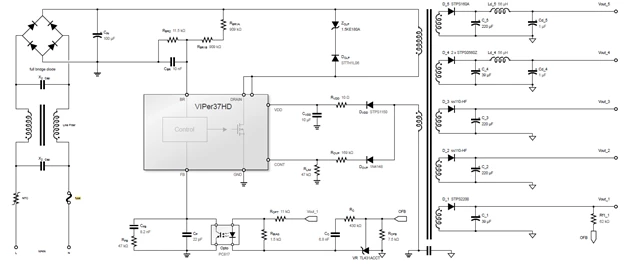

and according to our need we have used your eDesignSuite - Design, Circuit and Simulation Tools and the tool gave us this circuit in figure[1] (I also added the tools exported document with all parameters).
                                                                                   Figure [1]
And as you see in figure [1] the used converter is VIPER37HD, and we ordered it with the other components according to the schematic given in figure [1].

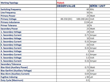

We also made 2 different transformers according to schematic that was given by eDesignSuite as shown below
For 60KHz switching frequency:

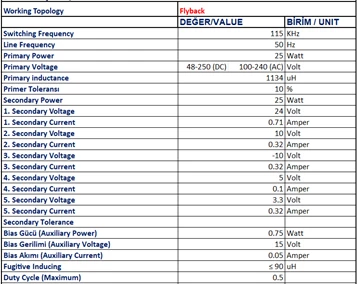

 0693W00000KZdUUQA1.pngFor 115KHz switching frequency:

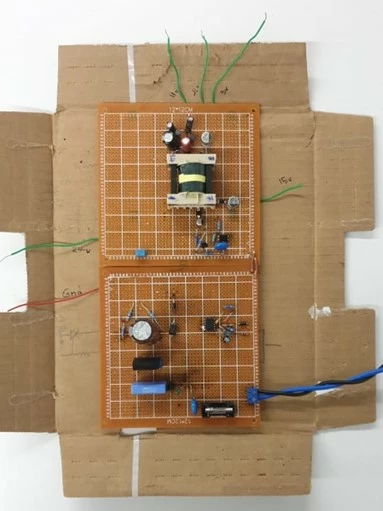

According to the changes I mentioned previously We made the circuit as shown in figure [1] in the lab on PadBoard as shown in figure [2]
 0693W00000KZdUjQAL.jpg                                                                            figure [2]
After applying power to our circuit, we still did not get our desired outputs while measuring using multimeters. we tested every component individually before testing VIPER37 and simulated it using proteus (simulated the circuit till the inputs of VIPER37).

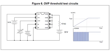

We thought the source of our problem could be from VIPER37L, so we tried to test it according to the test circuit provided in the datasheet that we got from your official website. The test circuit is shown in figure [3].
 0693W00000KZdUtQAL.png                                                                                   figure [3]
We created the circuit according to figure [3], connecting all the DRAIN pins together alongside a 10KOhm resistor and using our DC power supply (1st channel) to provide it with 30V. The GND and BR pins were grounded. We provided 14V to the VDD pins using the other channel in our DC power supply and used an ARDUINO UNO alongside a voltage divider to give 2V to the FB pin and 5V to the COUNT pin. We made sure the grounds of the power supply and the ARDUINO UNO were connected together at one point.

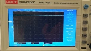

And in the oscilloscope, we supposed to see a square wave as shown in figure [3] but we only saw an DC signal as shown in figure [4] and when changing the signal mode from DC to AC in oscilloscope we saw an noised AC signal as shown in figure [5].

One of these reasons is that you are trying to get 25W in output, but consider that in Wide range it's better, for this device, do not go over 15W. In fact, from the report you attached, I can see that a very high temperature is reached and this can explain why your first attempts failed with VIPer37HD.
Regarding your second issue configuring OVP, I have some suggestions from the application engineer of this design, but consider that your board could have bigger problems that affect OVP behavior.
However, he suggests that you can set directly 14V, because you have to overcome Vddon value (15V) and then set Vdd to an higher voltage (16V) and then decrease to 14V. See figure 6 in the datasheet, “Adjust VDD above VDDon startup threshold before setting to 14 V�?.
Then you should provide 2V on FB and an increasing voltage on CONT pin, and verify that, while VCONT < 3V, DRAIN voltage oscillates near to the switching frequency and, when VCONT > 3V, it stops oscillating.
