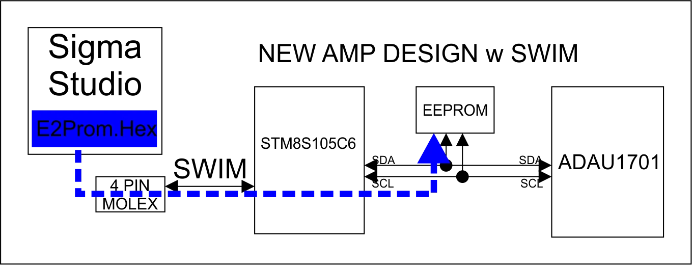

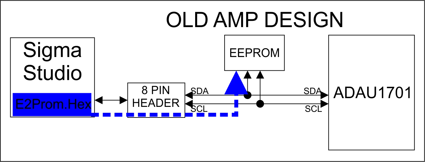

    A couple of graphics that may help some.
    Here is the old design. It had an 8pin header that I was able to use an adapter to connect to and it allowed SigmaStudio to work directly with the ADAD and also allowed writing to the e2prom to enable self-boot. SigmaStudio generates the e2prom.hex file that is stored in the 24c64wp.
    Here is the new design:
    They are using an STM8 to generate the hex file that the e2prom requires for the ADAU to self-boot.
    The blue indicates what I need to accomplish... use SWIM to open up the I2C ports of the STM8 to transfer the E2Prom.hex file to the 24c64wp.
    Hopefully this makes sense given my lack of proper terminology.
    Thanks in advance,
    Mick

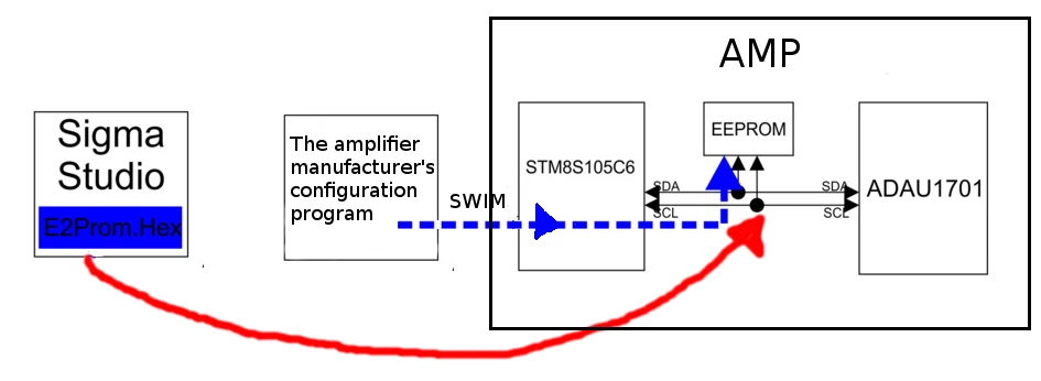

    Karol Merski
    September 17, 2018
    I understand it like that (image is in attachment)
    MFarl
    MFarlAuthor
    September 17, 2018
    Yes, you are correct with regard to the architecture but there are no accessible pins for I2C to the EEPROM so I'll have to find a way to go through the STM8 using SWIM as those are the only pins I have access to.
