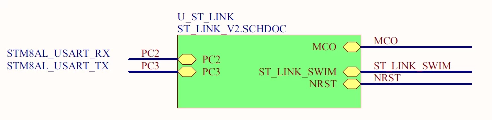

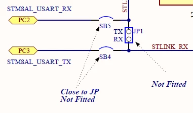

    First of all i'm going to check is something is sent via STM8AF_USART_TX with an oscilloscope.

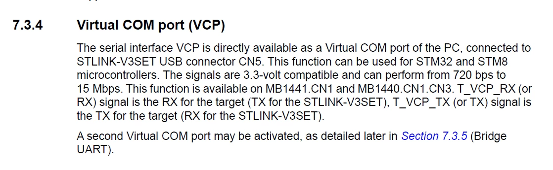

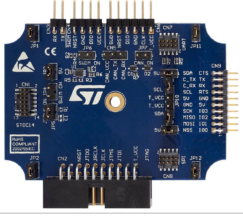

    Then i'll try to use this (because i found one) : https://www.st.com/en/development-tools/stlink-v3set.html
    Sounds like i can create a virtual com port with that but I don't really know to what should I connect STM8AF_USART_TX and STM8AF_USART_RX. Well, to my mind i must connect STM8AF_USART_TX to stlink-v3 RX and STM8AF_USART_RX to stlink-v3 TX.
    Here are some screenshots to explain why i should do that :
    Screenshot of stlink-v3 datasheet that talks about VCP
    0693W000000WN5XQAW.pngScreen shot of STM8AL3L68 datasheet
    and finally a screen of the hardware board MB1440 that is included in stlink-v3 0693W000000WN66QAG.png
    Tell me if I'm wrong !

    Ok i found the solution, the problem came from SB4 and SB5 that there were not Fitted
