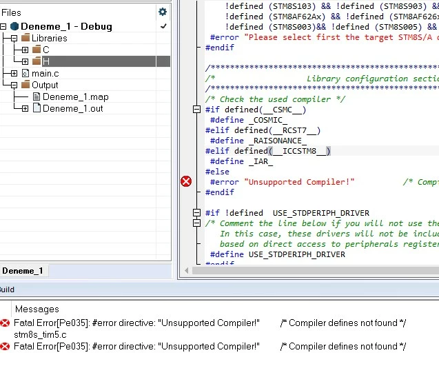

Unsupported Compiler! Error
Hi everyone! I m trying to compile my project but there is a problem. I use IAR as compiler and STM8S103XX. Why is that?0693W00000Y7X75QAF.jpg

    The reason of the problem is downloading wrong IDE. I thought there is just an IAR IDE and downloaded IAR. However I needed to download IAR STM8. So, problem solved.

    So perhaps a newer version of the compiler with a different define.
    Find the define or a contemporary ​version of the compiler/tools.

    Thank you for your help. I couldn't find contemprory version of tools. How can I find them
