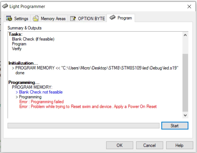

I am using a STM8S105C6T6 in one of my application and I am facing problem while programming it.
Software used: STVD version 4.3.12
Compiler: Cosmic CXSTM8 Special Edition 4.5.1 (Free 1yr License version)
I have build my application and when I click on ''start Debug'' in STVD, below error comes
Debug Seesion:
Starting debug session...
 -> Emulator reset (usb://usb)...
 done.
Opening application C:\Users\Micro\Desktop\STM8\STM8S105\led\Debug\led.elf...
 -> failed to download application: error: swim prog error [42004]: memory write error
Application closed.
Debug session closed.
2. When I am Trying to Program using STVD in-built Programmer, it is showing below error:
''STVD > Tools > Programmer'' or using STVP.
Programming...
PROGRAM MEMORY:
> Blank Check not feasible
> Programming
Error : Programming failed
Error : Problem while trying to Reset swim and device. Apply a Power On Reset
The interesting thing is, sometimes the MCU is getting programmed (LEDs are blinking as per requirement) but the software is showing same error message as above.
I don't understand why I am getting this error. My hardware connection and the SWIM communication are OK because I am able to program my other MCU i.e. STM8103F3P6 bare minimum board using same settings in STVD
How can I solve this error ?
Thanks in advance.

    I am also facing the same issue.
    Please check this : https://community.st.com/s/question/0D53W00000gfqjeSAA/stm8s005k6-swim-prog-error-42004-memory-write-error
    Did you managed to solve it ?

    Is there anything that might disturb the NRST function? Such as a large capacitor or a pull-up resistor? Also, as suggested in the other post, is there a suitable capacitor on the VCAP pin? Is the power stable? Do the powerline(s) have good decoupling capacitors?
    LGeor.2
    April 7, 2021
    VCAP is having 1uF capacitor. I tried with laptop power supply via the programmer, also tried by giving separate power to the chip. Both having similar results.
    Everything was working good, and I programmed few times without any issues. Suddenly it stopped working. I even tried using a different hardware, same results.
    But working fine if I try with a different chip.
    WilkoL
    Senior
    April 7, 2021
    And nothing strange on the NRST line? Well, then it looks like you need a new microcontroller....
