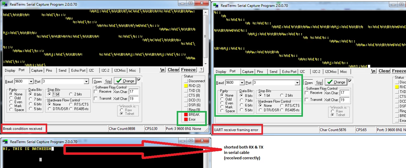

    T.Ratheesh
    August 13, 2018
       Thanks for your response
    I have modified code as per your suggestion, it was compiled successfully in IAR but still output is printing garbage values only in terminal.
    I have used two type of terminal software to test this
       1. TeraTerm
       2. Realterm
    Both terminals are printing garbage values only but Realterm terminal software gives below warning message
       "Break condition received" (refer attached image file )
       "UART receiver framing Error"   (refer attached image file)
    I have tested my serial cable in two methods
        Method1 : tested with other microcontroller, it is working
        Method2 : shorted both TX & RX in serial cable, it is working (refer attached image file)
    Please refer the attached image file for more understanding
    My Questions are
     1. Whether my STM8S105C6 discovery board is get damaged with UART functionalities alone (because led blinking program is workinng)?
     2. Have any other way to check UART?
    Please share your idea to solve this problem.
