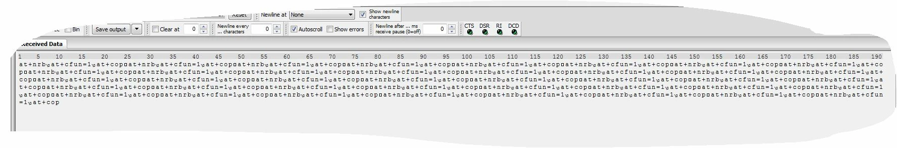

I am using the stm8l151... mcu and I am trying to send different strings via Uart1 to HTerminal. I have three different strings to send. The first two strings are transmitted completely but when the third one is being sent, it is truncated and it starts to send the first and second string again and repeatedly.
I have attached the output from Hterm (uart_com) for better understanding and also some parts of my code(uart transmit and uart_init)
Just for better understanding of the attached output, the strings(cmd 1, 2 and 3) are at+nrb, at+cfun=1, and at+cops=1,2,"26201"
Please Any suggestions will be greatly appreciated.:smiling_face_with_smiling_eyes:

did you try ti check the TC bit instead of the TX bit ?
sanctified
Sep 18, 2018 1:25 PM UTC
Thanks for your reply.
Yes i did. Still the same.
Am still on it and no solution:tired_face:
Any other suggestions and Please do you know another forum where i can ask such questions?

Stack Exchange?
Perhaps you have local support groups or others with familiarity with STM8 parts.
You might have to break out a debugger/scope to understand what's happening. I think some of the libraries have working examples, start with those.
I'd probably front test TXE.
If you have repetitive code consider using subroutines, and remember strlen() doesn't count the NUL whereas sizeof() does.

Solved it. It was the stupid watchdog timer:face_with_tears_of_joy:
