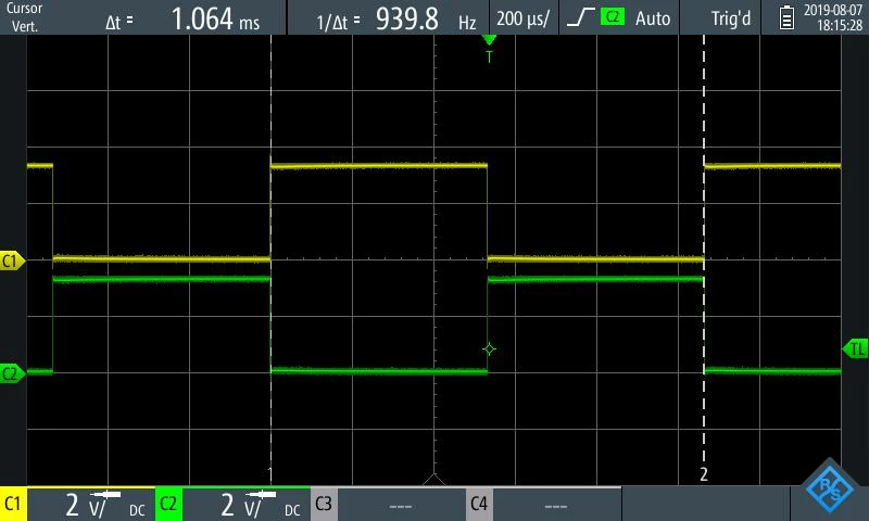

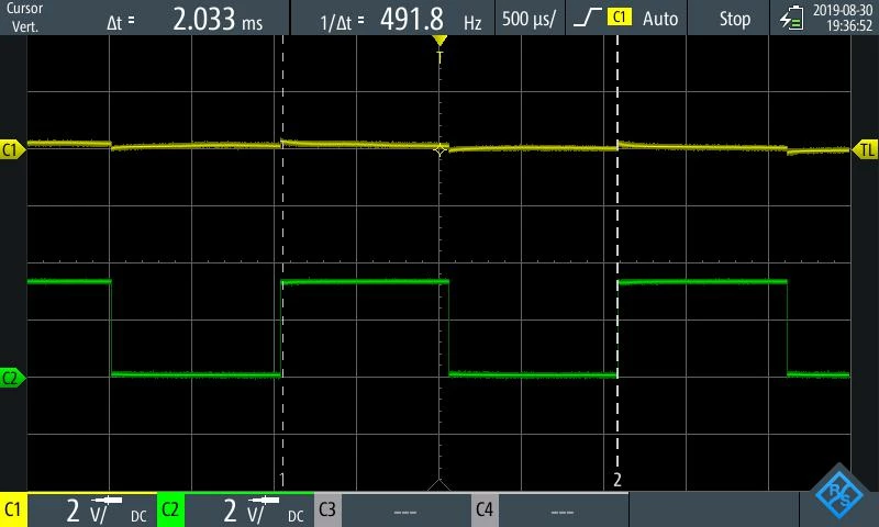

0690X00000AQLE6QAP.jpg0690X00000AQLE1QAP.jpgHello! I'm learning to code an STMicroelectronics 8 bit micro-controller. I want to control a BLDC motor with this MCU for electric vehicle application. I'm using the STM8S DISCOVERY Board, based on the STM8S105C6T6 (48 pin) MCU. This MCU has 4 timers, with TIMER 1 being the advanced timer (complementary PWM channels, dead time capability etc. in output compare mode). However I'm facing difficulty in generating PWM signals from the TIMER 1, which has 4 channels. Channel 2 and Channel 2N produce complementary PWM outputs as expected. However every time I connect Channel 1 and Channel 1N pins respectively to my oscilloscope (or Channel 3 and Channel 3N pins), Channel 1 (or 3) produce nearly no output while their counterparts produce perfect PWM pulse train. Channel 4 also produces a correct output PWM, but it doesn't have a complementary pin. Given below are the codes which I've used (the one released by STMicroelectronics itself as well as the one I've written on my own) and the oscilloscope waveforms I'm getting with Channels 1 and 2 for both cases
