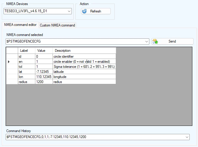

    Thank you for your response. Anyway, I've tried using $PSTMLOWPOWERONOFF and now its working as expected.
    However, now I got another issue. I'm trying to set geofence using $PSTMGEOFENCECFG and it says $PSTMGEOFENCECFGERROR*06 and here's the command that I sent to my Teseo.
    0693W00000YAX4uQAH.pngDo you know where did I go wrong? I'm kinda lost since it only says error without any details.

    May be, ID should start from 1?
    AVike.1
    Visitor II
    February 13, 2023
    And radius value format as double: 1200.0?
