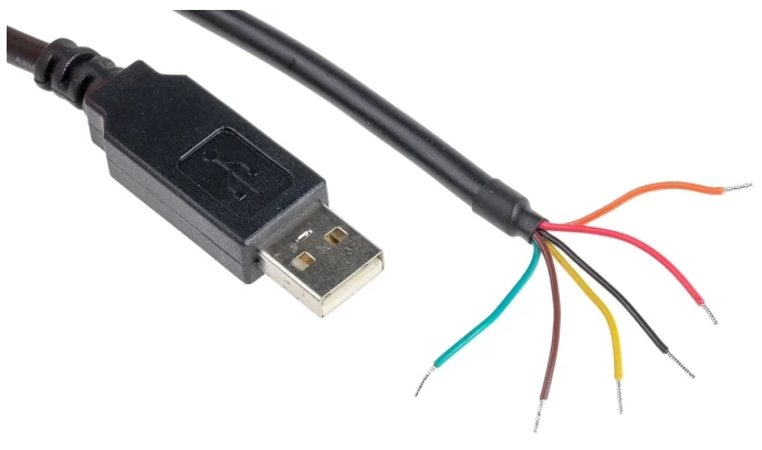

You can use any terminal.
No need for any firmware - just use a standard USB-to-UART adaptor; eg,
https://ftdichip.com/product-category/products/cables/
(other brands are available)
Vincent31Author
Aug 10, 2026 2:24 PM UTC
You mean by modifying the hardware to access directly the GNSS RX/TX signals ?
Andrew Neil
Aug 10, 2026 2:41 PM UTC
Yes
Vincent31Author
Aug 11, 2026 7:32 AM UTC
Ok, I’ll try with the adaptor.
Thanks !
