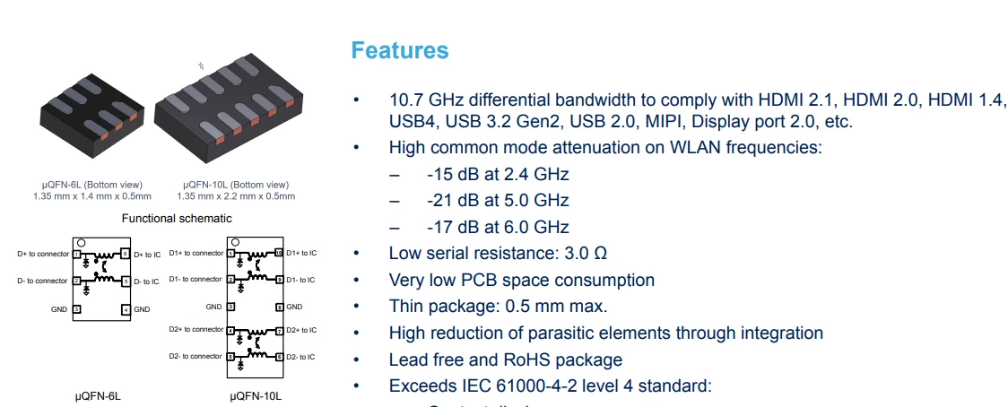

Technical questions about ECMF2-40A100N6 pin swapping
ECMF2-40A100N6 is a 2 lines Common mode filter with ESD protection for High Speed Serial interface
https://www.st.com/en/protections-and-emi-filters/ecmf2-40a100n6.html
The input is identified as D+ to connector and D- to connector. The outputs are identified as D+ to IC and D- to IC. Can the D+ and D- sections be swapped for layout reasons?

 D+ and D- sections can be swapped .
I see no problem, because signals are differential/symmetrical, so its no different condition to exchange them.
Just connector side vs ic side cannot be changed, because the protection diodes have to be at connector side.

Thank you. This is my interpretation too and is also in the app note as symmetrical ports for generic parts:
https://www.st.com/resource/en/application_note/an4511-common-mode-filters-stmicroelectronics.pdf
The datasheet is very specific with pin names so I need to confirm that they can be swapped. Also, the part can be used for other high speed channels and they are not called out in the datasheet similar to the USB connections. I wish they had called them ports in the datasheet.
