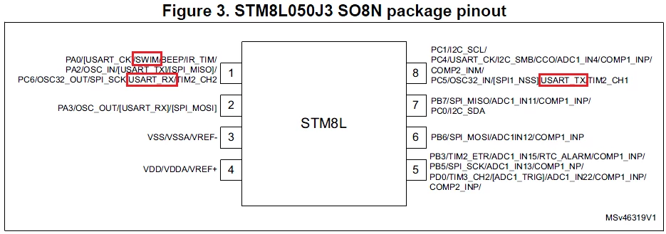

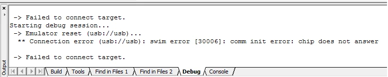

a communication error occurred on STM8L050J3 while studying.
i use STVD, ST-LINK/V2 ISOL, STM8L050J3.
it was't working after download to USART.
i think that SWIM communication(Port A0) and USART_RX(Pin C6) is Pin 1 as same, so two communication crash.
could you help me how to repair the chip?
