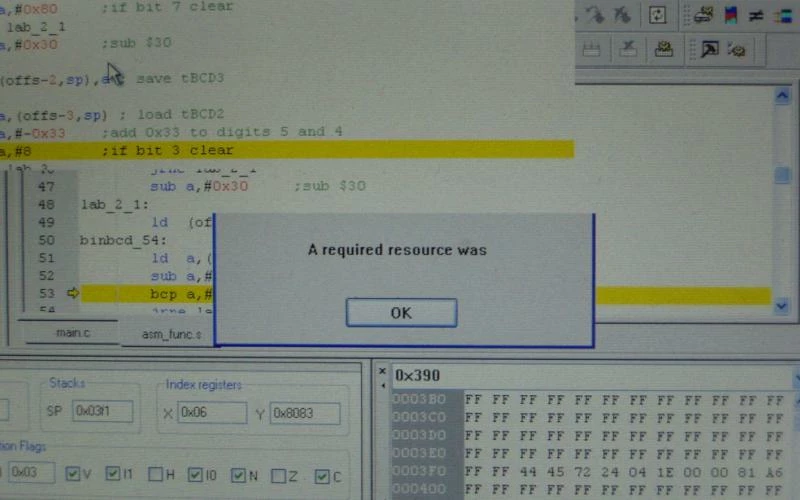

STVD Debuger error
Posted on December 08, 2011 at 15:57
In debugger STVD permanently there are failures. Only reboot helps
    7 replies
    pavelp1800
    Dec 9, 2011 5:02 AM UTC
    Posted on December 09, 2011 at 06:02
    The debugger was killed by one command of the assembler (bcp a,#0). After changeover on bcp a,#1 all began to work.

    I have seen this problem before it use to happen a lot.  I think STVD leaks memory, that is it does not free up all PC resources it uses.  When you use it most of the day you can get this problem.  You need to shut down and restart the application which frees up the resources.
    I have not seen this problem with later versions of STVD.  Maybe if you are using an older version you should download the latest version.
