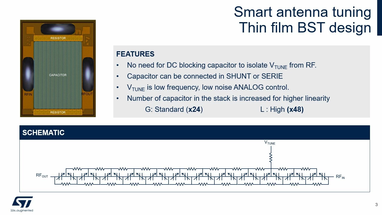

If, for example, RF1 is biased at 5V DC, and RF2 is biased at 3V DC, what will the be reference voltage to the "bias" pin?
JPROO.1
December 7, 2020
Please see internal schematic
if RFin and RFout are not using the same DC voltage there will be leakage current
