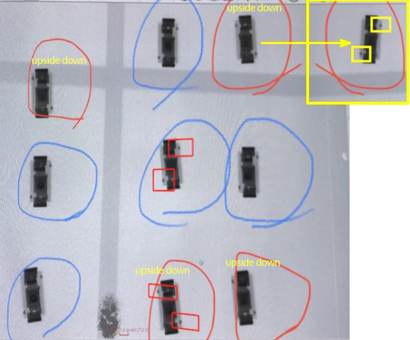

X irradiation was done on this product, and it was found that the position of the arrow was inconsistent. The same batch and the same plate of material were compared. What is the reason for this? Does it affect the performance use0693W00000Y7wS8QAJ.png

    Welcome, @应姣 �?�​, to the community!
    Now, if you look closely at the X-ray, you will notice that the components marked in red are mirrored, i.e. turned upside down.

    Unfortunately, you can't see on the Xray where the STPS2150s were photographed, i.e. whether they are on a board or just xrayed somewhere.
    If you mirror the components outlined in red, i.e. turn them upside down using the graphic editor, as can be seen in the example at the top right, then they look normal, right?

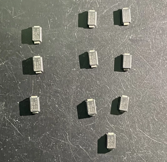

    My device pendulum is exactly the same, 9 devices a picture taken down, I asked why through a batch of the same plate in the same direction taken out of the internal structure is not the same0693W00000Y7xBwQAJ.png

    Ah, now I see. That's an interesting observation that only the quality department can answer. The best thing to do is to discuss this with your distributor, where you bought the parts, and ask them for a statement.
