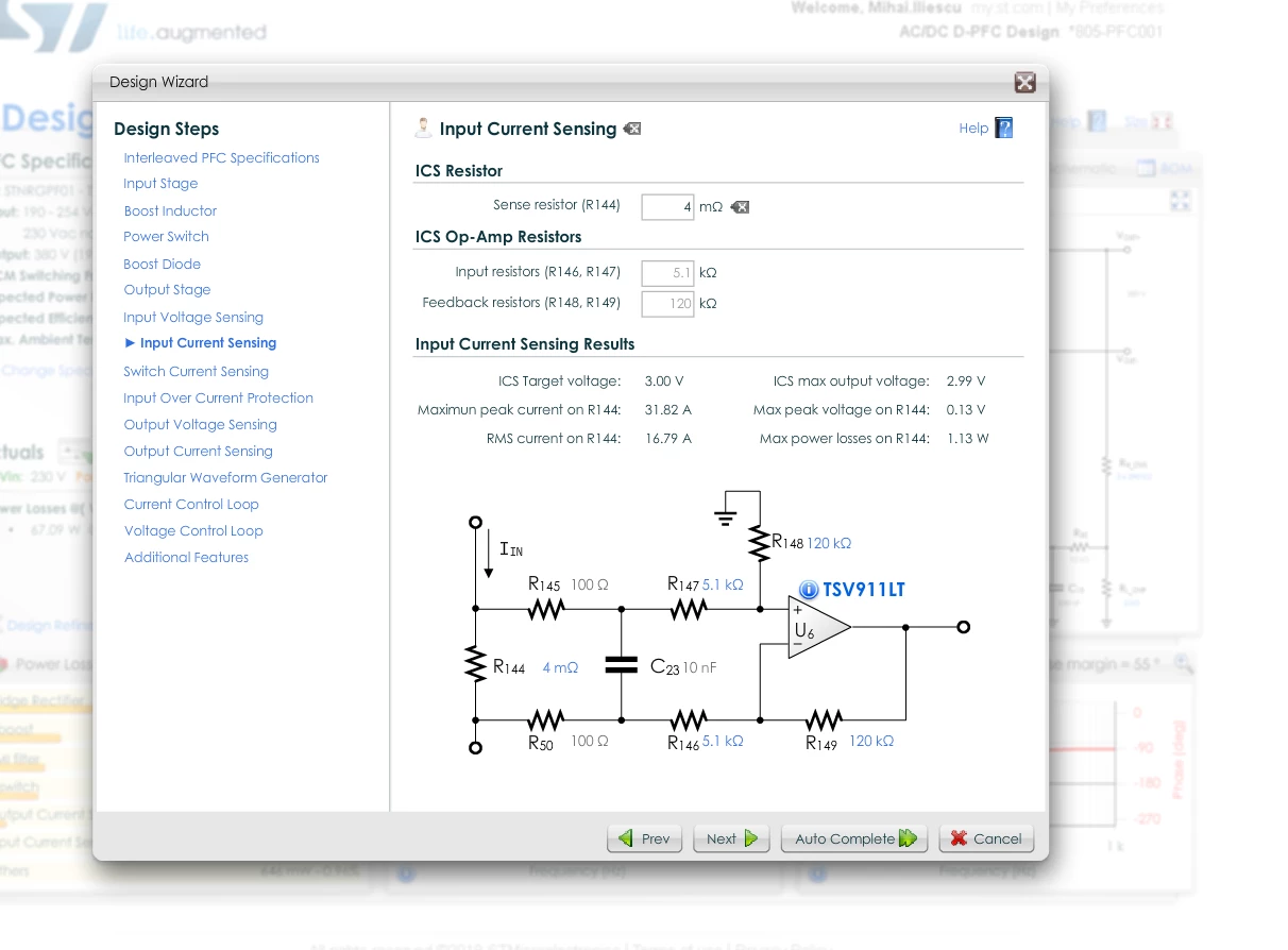

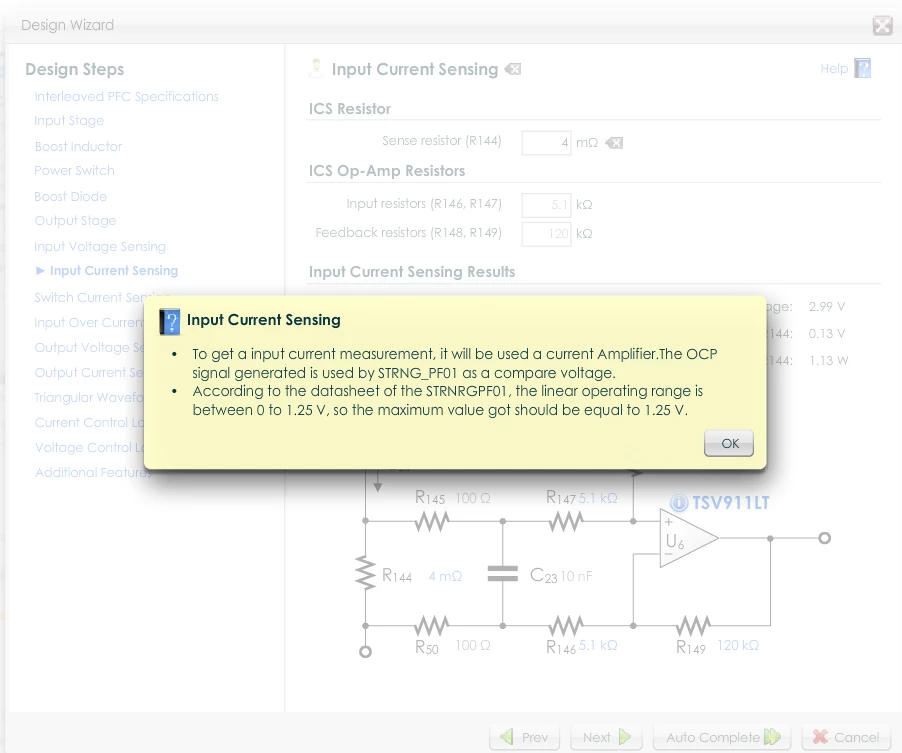

I found a problem in eDesignSuite when i try to use STNRGPF01 (PFC boost interleaved IC).
At input current sensing the ICS Target Voltage is 3.00V and in the datasheet the ICS Target Vltage looks like it is 1.25V (also in the Help section of eDesignSuite). Which one is correct?

    Hi Mihai,
    In short 1.25V are a limitation on inside comparator present in this family products, as specified in pag 32 (table 14) of datasheet (https://www.st.com/resource/en/datasheet/stnrgpf01.pdf)
    So every time user have necessity to compare a signal using internal comparator, the pin should have following range 0-1,25Volts.
    This is the golden rule, in solution proposed, applied on
    - Input Voltage Sensing Circuit,
    - Output Voltage Sensing Circuit,
    - Output Current Sensing Circuit,
    where output go directly to a STNRGPF01's pin for comparision.
    On the contrary on  Input Current Sensing Circuit, the output of this module is a input for PI regulator so only in this case we can use a different target voltage according to the IC used in the Current Control Loop (https://www.st.com/resource/en/datasheet/lmv321.pdf).
    The two resistors R58 and R62, between PI's output and OUT_PIN, give a scale factor of 0.635 that ensure the correct voltage on OUT_PIN pin.

    Carmelo VICCICA
    Oct 17, 2018 3:12 PM UTC
    Hi Mihai,
    Thank you for your interest in ST Portofolio.
    About your question.
    The information on the "Help" is older and refers to the first version of the proposed solution, so please refer to the information in the ICS wizard.
    Thank you for reporting, we will update this information on the next version, which should be released by 2018.

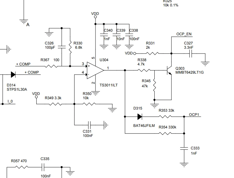

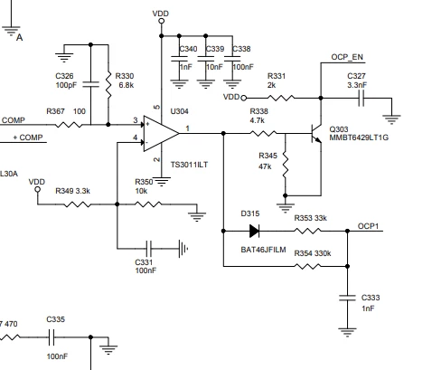

    I got another question (i will use your link - https://www.st.com/resource/en/data_brief/steval-ipfc01v1.pdf for the schematic).
    In the 4th page, where is the comparator circuit (U304) your negative input is ~ VDD(5V)*10k/(10k+3k3) = 3.75V. The input of the comparator is maximum 1.25V(-0.3 or -0.4 from the diode) so how it can ever switch?
    On the design suite, the resistor divider it is correct.
    So, you have RocpL/(RocpL+RocpH) x VDD => 5*1.8/11.8 = 0.70V - that's correct.
    So, i guess your board kit has a mistake?
    Best regards,

    Nov 6, 2018 4:27 PM UTC
    Hi Mihai,
    We apologize for the delay in the reply, but we are engaged in other projects.
    The documentation present in website refers to STEVAL-IPFC01V1 where all OP Amplifier are supplied with 5V, so the input of U304 will be have a range from [0 - 4,7V].
    eDesignSuite refers to a previous version of board where all OP Amplifier are supplied with 3V (EVAL-IPFC01V1).
    In the future eDesignSuite will be updated to match with actual documentation of STEVAL-IPFC01V1.
    Both designs are correct according to supply voltage selected for IC.
    Best Regards.

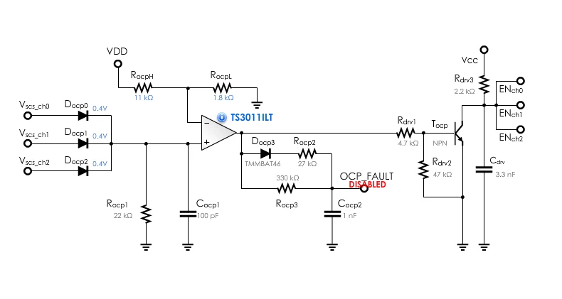

    Nov 15, 2018 3:05 PM UTC
     Hello again @Carmelo VICCICA​ ,
    I got another question about your STEVAL board.
    Here you can see that the output of U304 - an output of 5V is going directly into the IC (OCP[1] - which is a 1.25V maximum allowed) how that the chip still works?

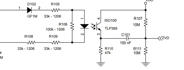

    Another question is about the ZVD signal and circuit, because it looks very strange and even in simulation i don't understand how it does work. I guess that it should give a pulse on the ZVD pin every time the signal is 0 (given that is rectified by that diode D102). But why those two resistance (R108 and R109)?

    Nov 16, 2018 10:35 AM UTC
    Hi Mr. Iliescu
    about your questions, below you can find some clarification how system works.
    Q: "Here you can see that the output of U304 - an output of 5V is going directly into the IC (OCP[1] - which is a 1.25V maximum allowed) how that the chip still works?"
    R: In case of consecutive OCP events, C333 is charged until the FAULT voltage level (1.23 V) is reached on OCP[1] PIN 28 of the STNRGPF01. At this point the system is stopped so the voltage cannot increase above 1.23 V, but in any case the pin is 5V tolerant so no problem.
    Q: Another question is about the ZVD signal and circuit, because it looks very strange and even in simulation i don't understand how it does work. I guess that it should give a pulse on the ZVD pin every time the signal is 0 (given that is rectified by that diode D102). But why those two resistance (R108 and R109)?
    R: Resistors R105, R108 and R109 limit the sensing current at few mA while R106 sets the voltage for a correct conduction of the optocoupler’s diode.
     During the positive half-cycle, diode D102 is directly polarized and optocoupler is turned on, so the capacitor C101 is charged and ZVD voltage is clamped to VDD-VCEsat. During the negative half-cycle optocoupler is open, hence capacitor is discarged through R110 and ZVD voltage is equal to GND.
    Best Regards.
