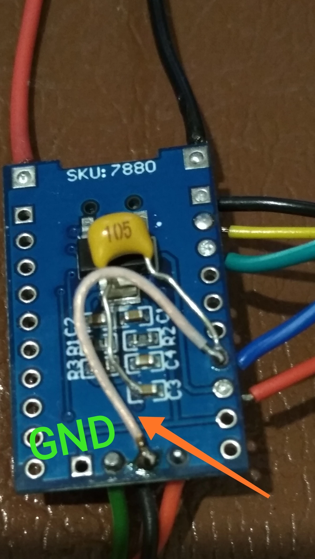

    Hi
    I have faced described error.
    The issue appeared after changin powering my STM8S003 board from USB to baterry source.
    In my case, short wire between GND pin on SWIM connector and huge ground polygon solved issue.
    Please watch a photo.
