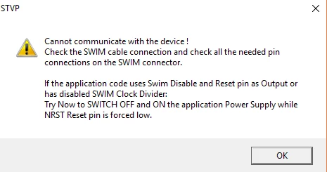

I was told to pull the NRST-Pin of the board to GND while switching power on / off and then try again, but that didn't help. I also tried to flash via STVP but i got this error message:
The last program i flashed works fine but putting a new program on the chip doesn't work
Anyone here who has a solution / ideas to this problem?

    maybe your NRST pin was Pulled down by hardware
    i have same problem in the past
    or you have high Impedance
    junction between VCC and GND

    Hi and thanks alot for your answer,
    What do you mean? Why should the board pull the NRST pin to GND from one moment to another? As i said i pulled the NRST pin to low (via a jumper wire) to mimic the SWIM-Initialization.
    Could you explain in detail how you fixed the problem in the past, please?

    in my case the reset button was burn
    so my MCU was reset Continuously
    but in your case i dont know so much
    i suggest you that put an amper meter before your supply and Measure the board amper
    so you find that any part of you PCB is burn or not
