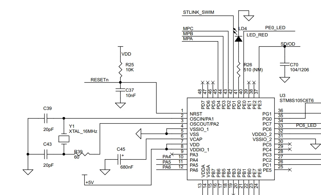

Program memory write stopped working for me. I tried with two STM8S005K6 chips. And everything works fine if I use some other STM8 chip.
Getting below error when trying using STVP.
Error : Programming failed
Error : Problem while trying to Reset swim and device. Apply a Power On Reset
Error : < PROGRAM MEMORY programming failed.
And below error when trying through IAR compiler.
Sun Apr 04, 2021 14:16:28: Failed to write chunk with size 1024 at address 0x8480: SWIM PROG error [42004]: Memory write error
DATA MEMORY and OPTION BYTE write is working perfectly. PROGRAM MEMORY read is working but NOT WRITE.

    Have you connected any capacitor at VCAP pin? Try the same and reprogram.

    Yes, I do have 0.1uF.

    OH looks like I need to use 1uF.

    I tried connecting 1uF capacitor, but it doesn't solve the problem.

    Check the datasheet/programming manual of the device, where the suitable value for the VCAP is given.
    I am using below circuit with my STM8S105C6 device. VCAP 680nF (recommended 480nF to 3300nF) and I am able to program it a couple to times.
    Currently I am also facing same issue. Once it gets programmed, I can reprogram it multiple times but as I remove and reconnect the ST-Link, it is throwing same error.
    Still trying to figure out what's wrong here. :\ :(

    For me it is not worked after that. I have 2 target boards. Both was working fine on the first day and I programmed continuously atleast 15 times without any problems. After that this problem happened and never worked after that. The 2nd board also stopped working at the same time.
    I tried replacing the 0.1uF Vcap to 1uF, that also didn't worked. Below are my next steps.
    1. Try with 1uF ceramic capacitor (currently I tried with electrolytic capacitor).
    2. Try with 680nF and other values ceramic capacitors.
    3. Remove the 0.1uF capacitor in the NRST line.

    I tried these, it is not solving the issue. For me it is working sometimes. Like out of 20 times it will work once.
