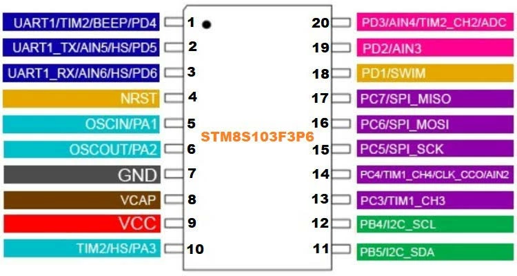

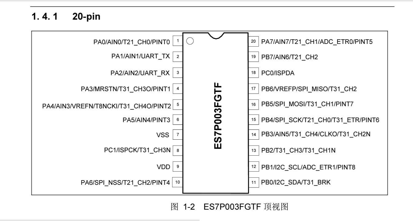

W1209 W1219 W3230 boards and several others of Chinese origin are usually equipped with STM8S003. But I got a board with ES7P003FGTF.
It looks like a PIC inside the body of an STM8. Programming system uses Data and Clock, and no capacitor pin for filter.
Is there any advantage of STM8S003 over ES7P003?
