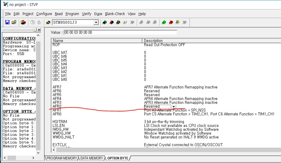

Hi
I am using
STM8S001J3
controller
on my project and I'm have some problem about it,
I want to use analog channel 2 on pin 7
However, AFR2 is disabled in STPV.
How do I fix it?
#analog-input #stm8s
    1 reply

    Yes, you're right, AFR2 choice is missing.
    The new version STVP 3.4.1 is available and correct this.
    Rgds,
