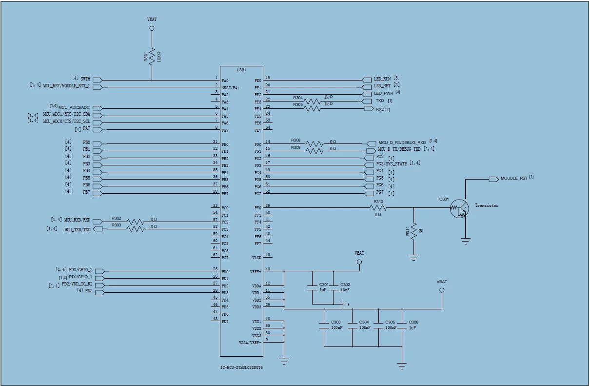

 I'm developing an application with STM8L052R8 MCU now, and this application is battery-used product. The problem is that, I cannot make the MCU consume micro-ampere order current.
I used every methods described in the reference guide manual, including active halt mode, and halt mode, but the least current indicator displayed 250uA. Of course I have stoped HSI, LSI, all timers and disabled all interrupts,disconnected other devices. GPIOs are also retested as push-pull low-slow output mode. I'm confusing.
 * @brief Config clock.
 * @retval None
static void CLK_Config(void)
 /* Enables the Internal High Speed oscillator */
 CLK_HSICmd(ENABLE);
 /* Configures the system clock as HSI(16 MHz) */
 CLK_SYSCLKSourceConfig(CLK_SYSCLKSource_HSI);
 /* High speed external clock prescaler: 1, then 16Mhz */
 CLK_SYSCLKDivConfig(CLK_SYSCLKDiv_1);
 /* Wait for clock stability */
 while (CLK_GetSYSCLKSource() != CLK_SYSCLKSource_HSI)
 * @brief Config GPIO.
 * @retval None
static void GPIO_Config(void)
 GPIO_Init(GPIOA, 0xFF, GPIO_Mode_Out_PP_Low_Slow);
 GPIO_Init(GPIOB, 0xFF, GPIO_Mode_Out_PP_Low_Slow);
 GPIO_Init(GPIOC, 0xFF, GPIO_Mode_Out_PP_Low_Slow);
 GPIO_Init(GPIOD, 0xFF, GPIO_Mode_Out_PP_Low_Slow);
 GPIO_Init(GPIOE, 0xFF, GPIO_Mode_Out_PP_Low_Slow);
 GPIO_Init(GPIOF, 0xFF, GPIO_Mode_Out_PP_Low_Slow);
 GPIO_Init(GPIOG, 0xFF, GPIO_Mode_Out_PP_Low_Slow);
 * @brief Config Low Power Mode.
 * @retval None
static void LowPower_Config(void)
 /* Configures clock during active halt modes */
 CLK_HaltConfig(CLK_Halt_FastWakeup, ENABLE);
 /* Enables the Fast WakeUp from Ultra Low Power mode */
 PWR_FastWakeUpCmd(ENABLE);
 /* Enables the Ultra Low Power mode */
 PWR_UltraLowPowerCmd(ENABLE);
 * @brief Initializes the board, services, drivers, application and other modules.
 * @retval None
void SYS_Initialize(void)
 /* Configures clock */
 CLK_Config();
 /* Configures GPIO */
 GPIO_Config();
 /* Configures Low Power mode */
 LowPower_Config();
 /* Disable system general interrupts */
 disableInterrupts();
 return;
 * @brief Run application tasks.
 * @retval None
void SYS_Tasks(void)
 halt();
 return;
 * @brief Main program.
 * @param None
 * @retval None
void main(void)
 SYS_Initialize();
 while (1)
  SYS_Tasks();
