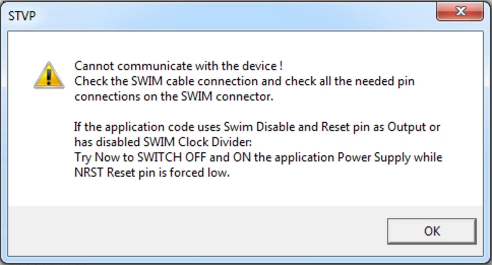

I am experiencing a serious problem with STM8L050J3.
Due to an unused pin configuration of port A (PA1..PA7) then excluding PA0 used as SWIM, in order to check for any difference in current consumption, I have configured Port A with the following command:
GPIO_Init(GPIOA, GPIO_Pin_1|GPIO_Pin_2|GPIO_Pin_4|GPIO_Pin_5|GPIO_Pin_6|GPIO_Pin_7, GPIO_Mode_Out_PP_Low_Slow);

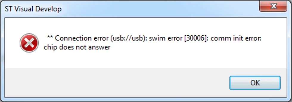

As a result, the firmware uploaded now does not run, and it is no longer possible to access it with ST-LINK V2, neither for debugging nor for programming.
Since the RESET pin is missing on this micro, there is no way to reset this situation and recover the functionality of the micro, which is otherwise no longer usable.

    I would agree with you if you were to use PA0 as I/O, but in my case I don't have this need, and I have configured pins PA1 to PA7 in Push-Pull Output Low mode for exploratory purposes only for current consumption, so I don't understand how this caused the SWIM pin, which is on PA0, to be blocked. In this situation, even having modified the firmware by adding a small power-on delay, I can no longer download it to the micro's flash, because I no longer have access with the ST-Link V2 and I have no way of resolving the issue other than by replacing the micro on my board.

    Package pins are bonded to multiple chip level IO-Cells, you can configure one of those as an Output, or they will fight, and block secondary usage
    Cristian Gyorgy
    May 17, 2022
    Hi!
    what you experience is no bug, PA0 is tied up on the same physical metal pin with PA2 and PC6. So,if you configured PA2 as output, the SWIM will not work anymore. Pls. see datasheet.
    So yes, solder a new chip and read the datasheet carefully before commiting to programming.

    thanks for the support!...Indeed, looking better at the DS especially the part of "Pin Description and Tables 3 and 4�?, I saw that some pins of the micro STM8L050J3 are internally connected together and therefore can not be considered disjointed and configure them independently as it happens for different models of STM8Lxx.

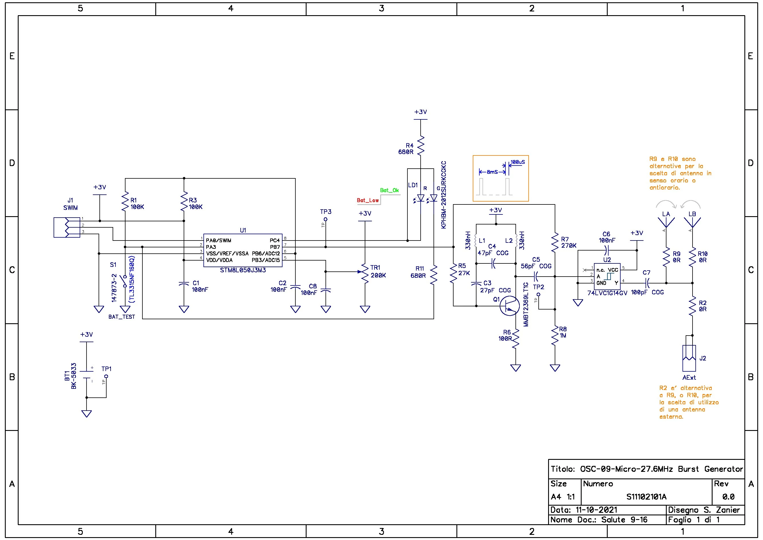

    However, by taking IDD current measurements, I am finding that in HALT-MODE, the absorption of my system, even physically disconnecting the HF part, is about 700uA, which I still consider excessive for use with a CR2450 battery. I am probably doing something wrong in the I/O configuration (I attach the diagram of my small project for your opinion on this).
    I am not familiar with the STM8 eForth environment and will look on GitHub to see what it is and whether it might facilitate me for projects with these small micros.

    I assume that your new circuit (with an STM8L051F3P6) uses the 38kHz LSI as the RTC clock (the WUT is a bit easier to use). In Active Halt mode the current consumption should be much lower.
