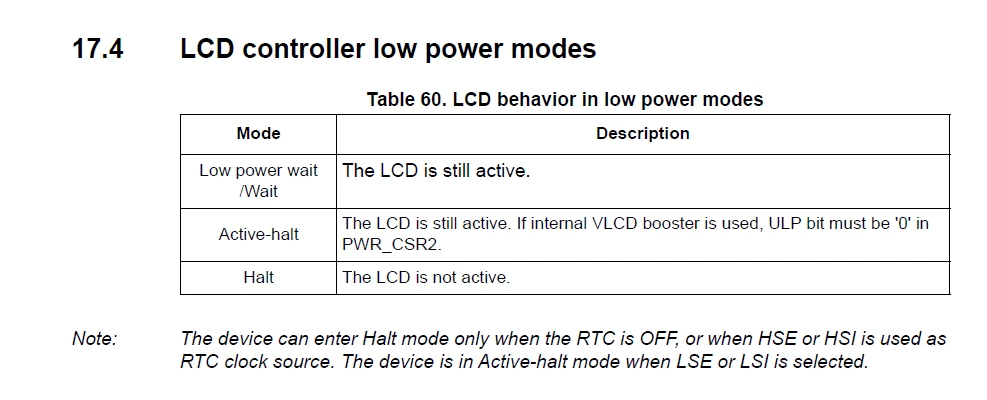

stm8l lcd low power
  • August 22, 2019
  • 0 replies
  • 883 views
mcu into active-halt mode, so i can not enable ULP?
if i set ulp to 1, then the lcd blinks
