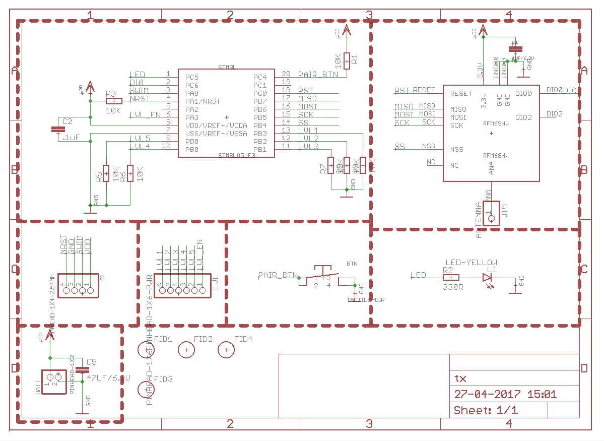

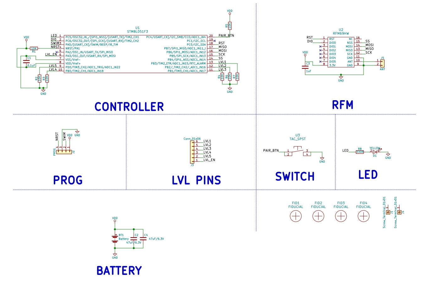

Thank you for your reply.This isthe schematic for the transmitter which employees a STM8L micro controller for its operation.
The is the full schematic design.
In the design of the transmitter, there is no functional change. The board size has been changed to fit into a new enclosure,whereby the layout has been changed.
Project 1
This is the old schematic (the working and deployed version):
This is the new schematic (version which has the issue):
According to the datasheet we need not put a pull up resistor for the NRST pin. Thoughthe former
design
worked flawlessly with the pull up on NRST, the latter didn't.
To rule out this mistake, we tweaked the design:
  1. removed the pull up resistor on NRST (kept it open) and checked the working of the board. Still the board shows the same behaviour.
  2. removed the pull up resistor on NRST (kept it closed) and checked the working of the board. Stillfailed.
  3. removed the pull up resistor and connected a 0.1µF capacitor to match the design on the datasheet. Still failed. In this case the board didn't reset abruptly but the current consumption was very high (0.5mA to 3mA).

I would strongly recommend to keep solution no 3 concerning NRST line (only 100nF capacitor to GND).
I can see 2 potential trouble makers in your design:
PB0 - this pin is kept in pull-up configuration during reset and then after the reset it is in input floating by default, thus it may demonstrate higher current consumption during reset phase due to external pull-down.
PC0 - this pin is True OD what means that it has not implemented neither P-buffer nor protection diode to Vdd, thus in case of output configuration it required an external pull-up.
Please have a look at pin description section of the datasheet for more details.
