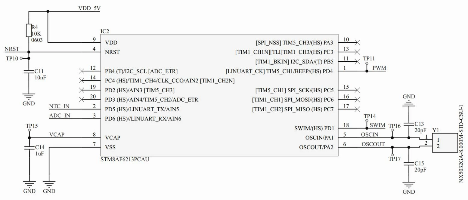

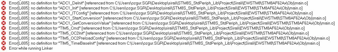

I am using STM8AF6213 MCU in my project. I am using PD6 (AIN6) pin to read analog value. I use PD4 (TIM5_CH1) to generate PWM. But the stm8_adc1.h and stm8_tim5.h libraries that I included in my project do not work properly. It does not see the functions in the library.
