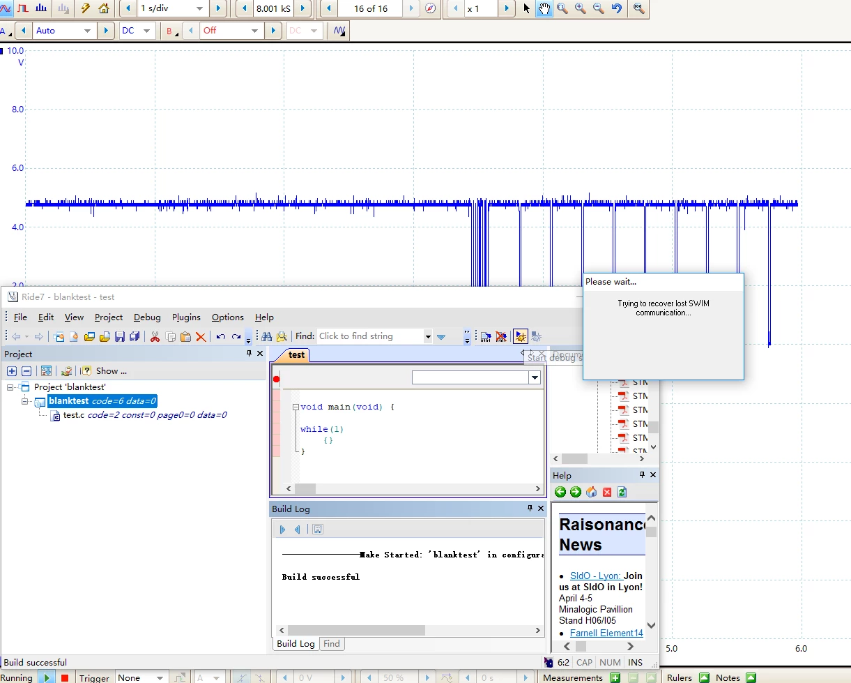

Dear all,
First I would like to thank you for any help that you might give me.
My purpose is to flash an empty code in the uC (STM8AF5288TAY) but its always says ''lost SWIM communication''.
After analyse of our self designed board, I remarked that the problem might come from the NRST pin of the uC.
There is only a condensator connected to this pin during my test :

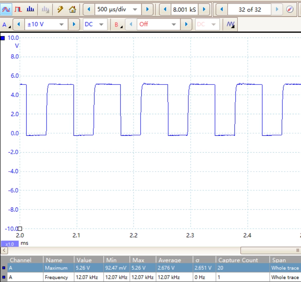

But you can see that the signal NRST(shown below) is not pulled up as it should be :

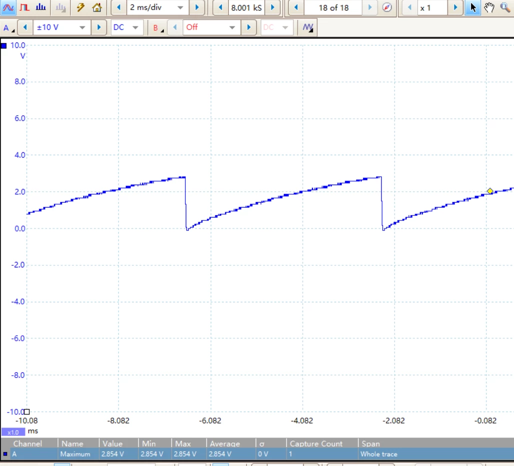

If I remove the condensator, I have this on the NRST pin :
Please can someone tell me why I have this signal in the NRST pin while there is nothing going on? In my undersanding I should have 5V straight while nothing is happening; So where this signal comes from?
I am really looking forward for an answer or advice as I can not find the solution since weeks and cannot flash any program.

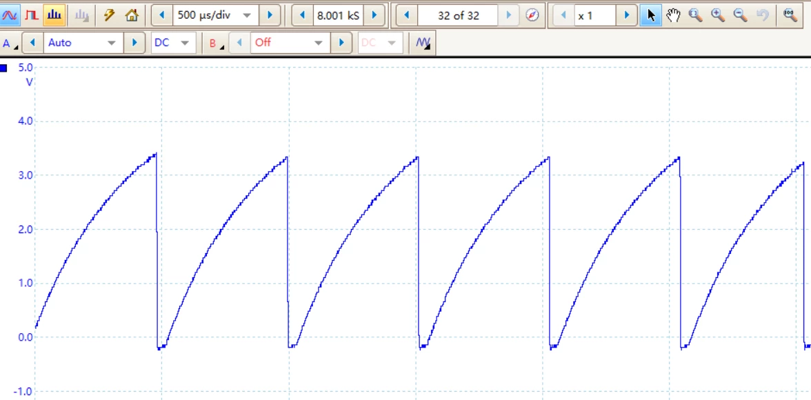

The datasheet specify the pull-up for around 40kOhm (see 10.3.7 Reset pin characteristics).
With the capacitor on the pin, we have a RC charge with a time constant of around 40kOhm x 10nF = 400us .
Am I wrong or this seems quite in line with the waveform you are observing?

Indeed, the signal that we are observing correpond to the constant time for 10nF.
Nevertheless, the ''square signal'' is the source of the problem and in my understanding, changing the condo will not solve this problem. Here is the signal when we have 100nF condensator :
Normally, this NRST pin should always be at VDD,so 5v (when nothing is happening). I do not understand why there is a square signal instead. Is it trying to restart over and over?
To my understanding, having this square signal means that uC is constantly restarting; then flashing program is impossible.

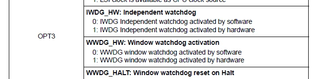

Maybe an invalid instruction in the code. If an opcode is not recognized, a reset is generated.
Try with a working example to confirm.
This seems a bit fast but it could also be coming from the watchdog...
Select the software watchdog mode in the option byte to confirm.
In hardware mode, you must service it in your code to avoid a reset.

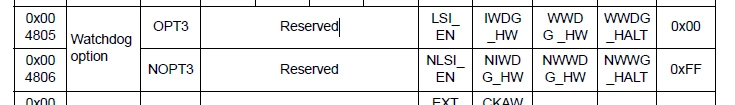

Could you kindly send me a working example that I could try? The ones in stm8 website are several GB sized :\
As I never succed in flashing a code and seeing that reset value of the option byte of the IWDG_HW is 0, I assume that the uC is already in software watchdog mode.

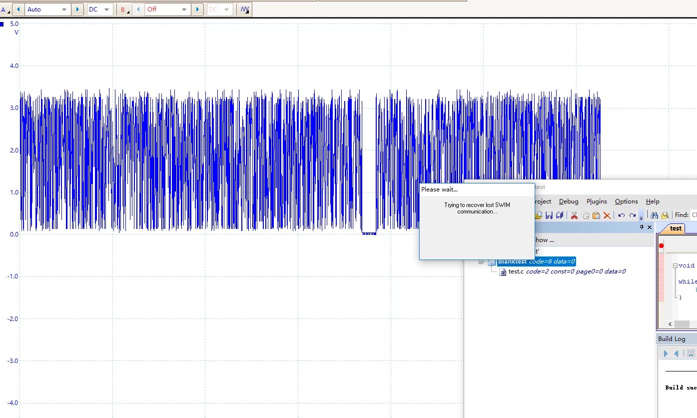

The SWIM interface does NOT operate when the device is under reset. There is only an 'entry' thing, but once it is done, the device must be released from reset. And that is the catch. If the device (cpu) performs a bad thing fast, it resets itself fast and you realize you don't have time to stall the cpu and begin the flash programming...
It is quite a bad design this SWIM interface. The swim controller should have been able to really run with the cpu under reset and be able to access the flash controller (at least) independently, and with the chip under reset. But these are dreams.
The reality is that you can brick the chip easily. ST gives a theory that you can catch a bricked chip with one in ten tryings... I don't know if it's true but I admit I managed to rescue some chips a couple of time with repeated tryings.
ST-Link dongles do a little trick: keeps the reset line low, and advices you to toggle the power in the mean time. And then, try again. Probably a power-on reset, with the reset line low already, helps.
For David: I'm afraid you have a bricked chip, one that resets itself very fast. You can try to program something on it with this procedure: use a ST-Link. When it advices you to toggle the power, do it. And keep trying programming it. If you are stubborn, you may succeed...
Something may be any valid program.

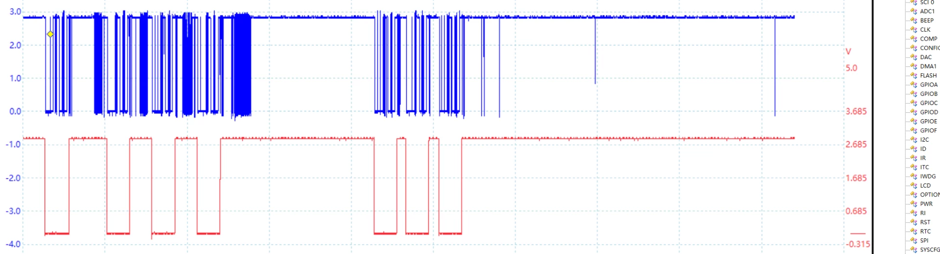

I tried fanatically to flash the code for half an hour but do not work.
This is the signal when the STlink tries to retablish the SWIM communication.
and the NRST pin at the same time/division0690X0000060AaIQAU.png
What do you mean by bricked chip? I already changed three time the chip and have the same results.
Do you know another way to force the chip to be flashed? Is this problem occurs lots of time?

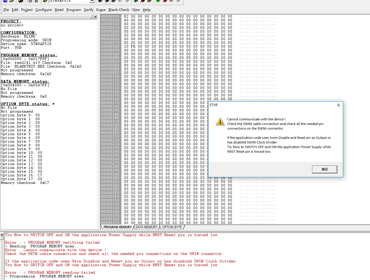

I downloaded the STVP and used the HEX file to flash the program.
Unfortunately, same problem occurs. The communication with the device is not possible :
The problem is that the Microchip is constantly toggling the NRST pin (screenshot are in the original post).
How can it be possible to still have this same issue knowing that I prepared the most simple circuit and with differents chip.

When you reach the state STVP from your screenshot:
- unplug you board to make sure the MCU is not supplied anymore
- force the RESET low and keep it low
- apply the supply without releasing the RESET
- now click the button on the message window
- then and only then release the RESET
If you succeed to connect that way, make sure to perform a global erase first

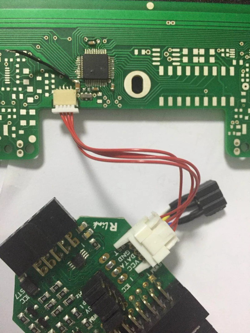

Yes VDD and VDDIOs are connected, VSS and VSSIOs as well. There is also a external capacitors VCAP-VSS which is 1uF.
Below, you can see how I connect to flash the code; The PCB contains only the condos for the VDDs et VSSs, NRST pin and for VCAP.
(Don't care about the black wire, it is not connected)
Do you have any suggestion about this connection?

I see that you're using Rlink probe, can you tell us which jumper you set or on which side they are ?
Can you try to connect in SWIM mode with an STLink ?
