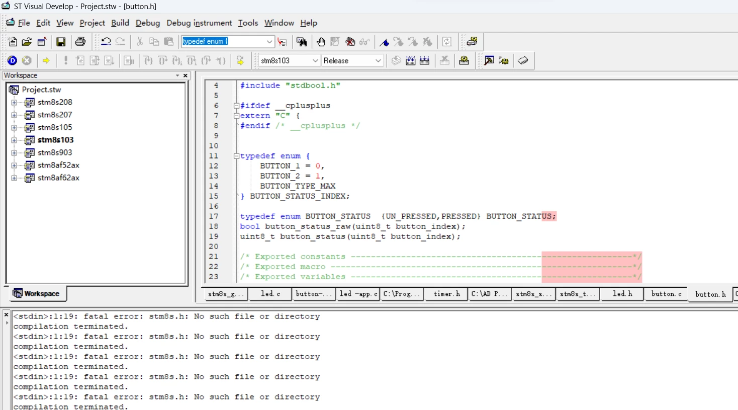

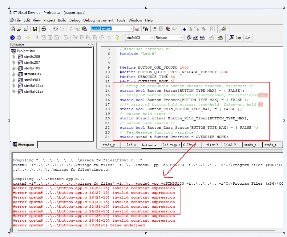

HI Guys,
 now I use STM8S103F2 series MCU develop, find there was some issue that can not solve, but i checked that bool types constant has no problem, so do you have same issue? thanks!
    2 replies
    December 6, 2023
    Looks like the problem is BUTTON_TYPE_MAX. How is that defined? The definition isn't in your screenshot.
    It needs to be a #defined constant in order for the compiler to know how big the arrays should be. It can't be a variable.
    gavin3Author
    December 6, 2023
    I put it is button.h files, following :
    December 6, 2023
    And what happens if you #define it as 2 instead?
