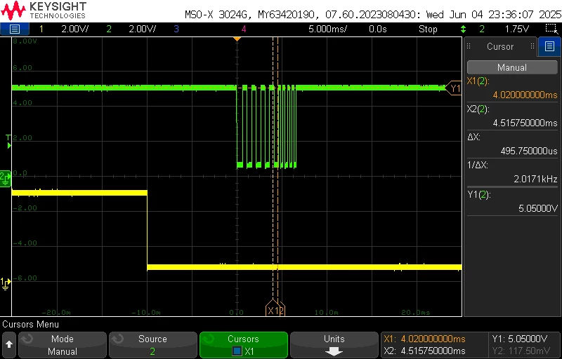

I’ve been working on implementing a SWIM master using an STM8 device to interface with a STM8S105K6 target. This is part of a tester software project that was previously using the ST7 debug protocol and is now being ported to the STM8.
I’ve followed the entry sequence described in UM0470, and I believe the waveforms match what's expected. Attached below is a screenshot from the oscilloscope:
  • Yellow trace = RESET pin
  • Green trace = SWIM pin
As you can see:
  1. A long low pulse initiates the SWIM entry sequence.
  2. Followed by 4 x 1kHz pulses and 4 x 2kHz pulses.
  3. Then I set the SWIM line high and switch it to input mode to await the slave response (Step 4 per UM0470).
However, no response is received from the target. The line stays high and never toggles.
Below is the relevant code section (i use raisonance ride7 dev environment):

    Best answer by ahsrabrifat
    If the target has an enabled watchdog timer and no main firmware, it could be resetting before responding. Either disable the watchdog or flash a basic dummy firmware to keep it alive.
    1 reply
    ahsrabrifatBest answer
    Senior III
    June 4, 2025
