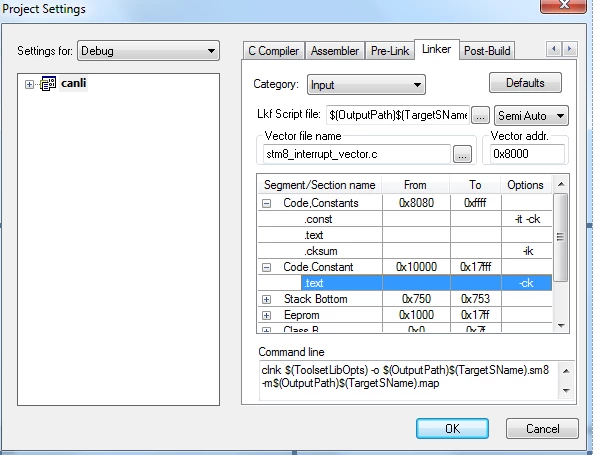

i used _blockcksum160 then we increase code size 32K to 64K
depends on code size increased;
we changed memory model +modsl0 to modsl.
We changed library list libislo.sm8;libmo.sm8 to libisl.sm8;libm.sm8
We changed startup file crtsi0.sm8 to crtsi.sm8.
When we run software, during runtime check. İt fails.
_block_checksum160() return CRC_ERROR.
Then we start to use _block_checksum161() however, it return error;
#error clnk Debug\canli.lkf:1 symbol _MSB_RunCrc16Chk not defined (Debug\_block_cksum161.o )
#error clnk Debug\canli.lkf:1 symbol _MSB_RunCrc16ChkInv not defined (Debug\_block_cksum161.o )
As i understand that stm8l_stl_classB_var.h ,which sent by ST guys, should update.
Where can be get
stm8l_stl_classB_var.h file which suit for 64K
stm8l_stl_classB_var.h :

    i have done another work
    . Depends on these work. May you result anything?
    We had one segmet(Code and constant) which locate 0x8080 to 0x17fff.
    _block_checksum161() return CRC_ERROR.
    Now we have 2 segment. First segment  for constant and code where locate 0x8080 to 0xffff, seconds segment is for .text where locate 0x10000 to 0x17ffff.
    block_checksum161() return OK
    Unfortunately we can not use first segment for .text.  .text which locate  0x8080 to 0xffff is not used.
    ?f .text of secons is overflow, it do not use .text of first segment. ?t gives overflow error.

    i add below parts;
    at [CLASS_B] section:
                EXTERN NEAR u16 MSB_RunCrc16Chk;          /* Current MSB of the address at FLASH */
    and [CLASS_B_REV] section there:
                EXTERN NEAR u16 MSB_RunCrc16ChkInv;     /* Current MSB of the address at FLASH */
    Compiler is ok however,
    How can i get
    _block_checksum16
    x
    () for memory model
    modsl (64K flash memory)?

    Posted on April 13, 2017 at 12:07
    from the Cosmic point of view, all you need to make the checksum work again after moving to a 'far' (>0xFFFF, that is 32k of code for the stm8) memory model is to use the far version of the checksum verification routine, and that is done automatically when you link libi instead of libi0.
    For your case however, you seem to use some checksum verification routines that are not provided by us (_
    block_checksum161()
    ), so the obvious answer would be to check with the provider of those routines (I guess that's ST) because I also see that some header files that you use force some variables @near, so I'm not sure if there is a @far version of the same file for when you change the memory model or if these variables are supposed to stay @near even when other parts of the code go @far..
    If you don't get out of it easily you can send your whole project to us and we'll take a look at it.
