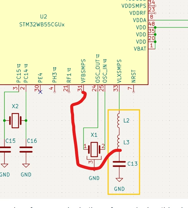

I trying to follow the UFQFPN48 reference design for a STM32WB55CGUx in KiCAD.
The ref design has some pinouts that don’t exist in the associated KiCAD symbol for the chip.

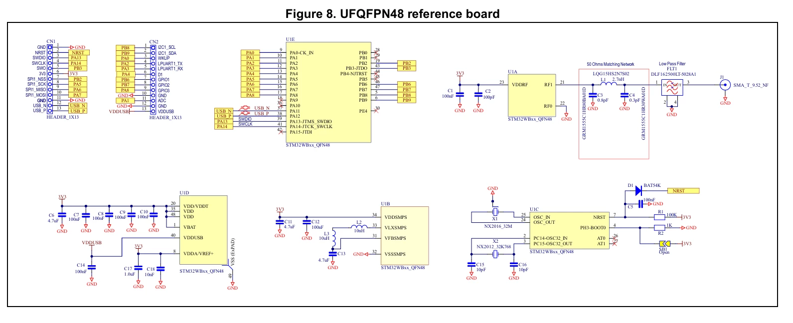

The ref design,

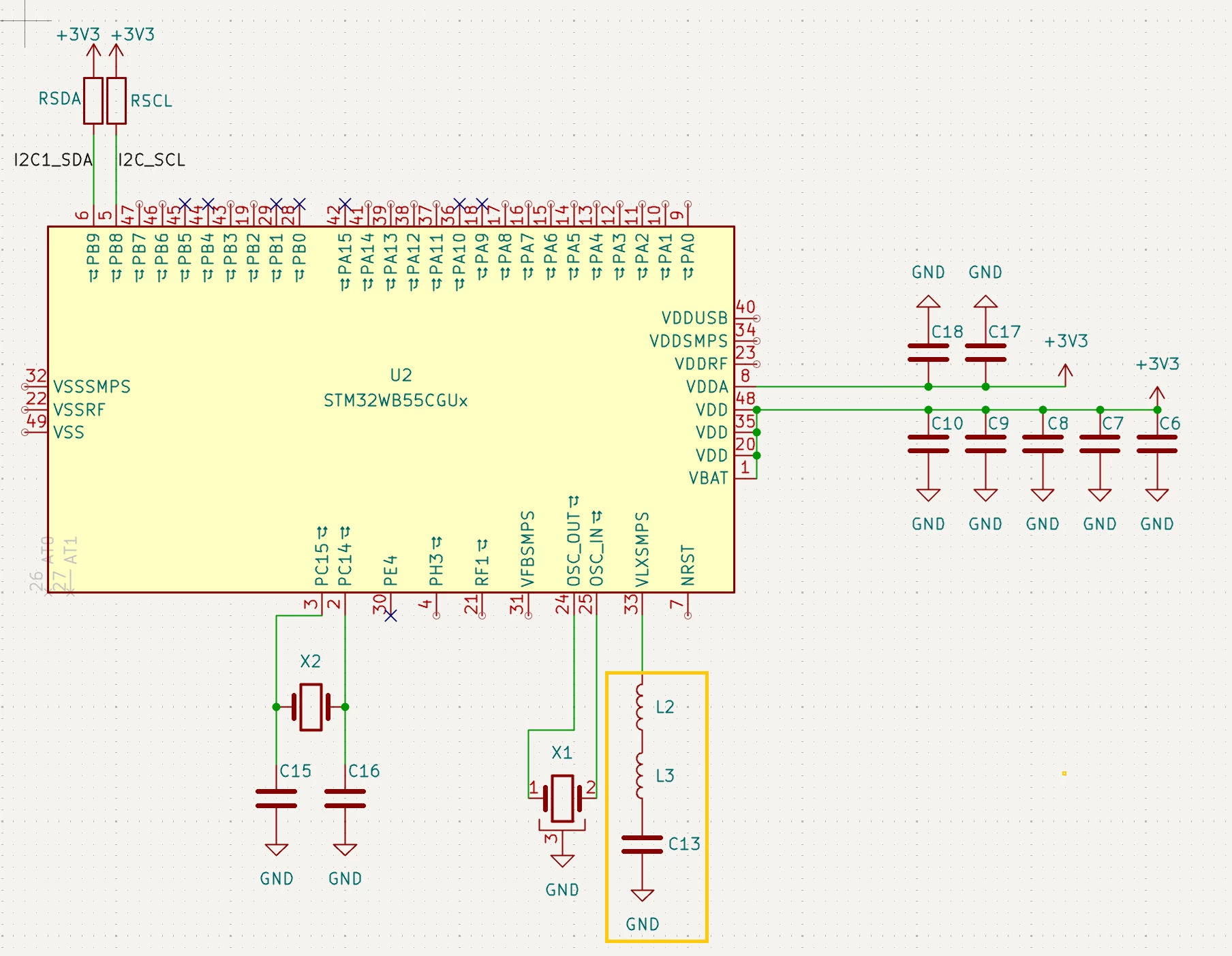

The KiCAD symbol with as much as I have wired up so far,
 So the branch in the orange box for example, in the refence design this should have a branch just above C13 going to VFBSMPS yet in the KiCAD symbol this is missing. also there is no RF0.
1 reply
October 6, 2026
What’s missing? VFBSMPS is clearly there.
Make the connection. C13 and L3 are separate components. Move them to expose the green net wire, if that’s what you want.
RF0 is pin 22 which is there as well. Left side.
