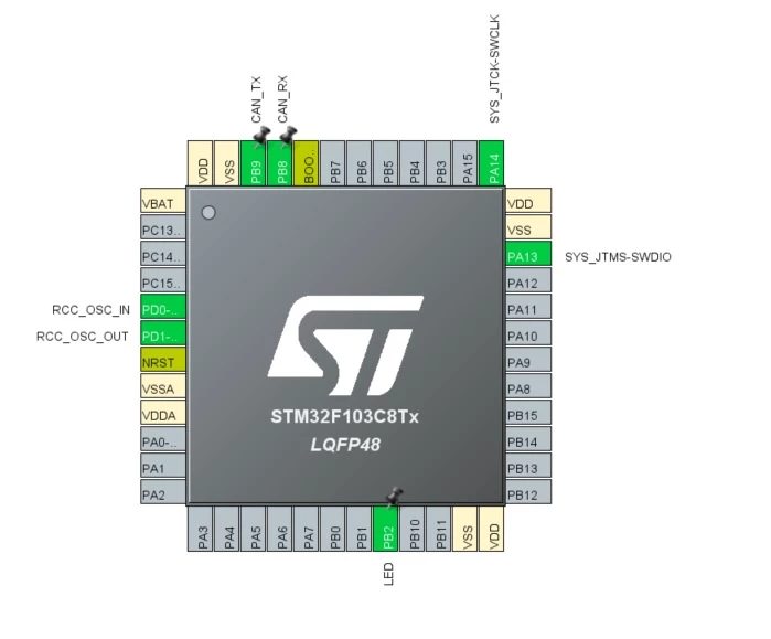

I'm trying to send CAN messages with the STM32F103C8T6 microcontroller (blue pill hardware with genuine ST chip) to a CAN analyzer without success.
I'm using STM32CubeIDE v1.12.0. I double checked the hardware, I'm using PB8 and PB9 pins to connect to the CAN transceiver (SN65HVD230 ) RX and TX pin respectively, I have 120 ohm resistor on both CAN line termination, I settled CAN baudrate to different baud but the result is always the same, no pin level changing on TX pin PB9, it remains always at 3.3V (looked with a scope meter), it seems that the CAN cell is not connected to the external pins. I'm not using the USB that is disabled, external 8 MHz crystal with PLL to have 72MHz clock. The code works because I have a LED that correctly toggle its status every 1 second, after a while the CANtransmit function HAL_CAN_AddTxMessage(..) return an error because it doesn't find a free trasmit mailbox. Attached the main function, please help

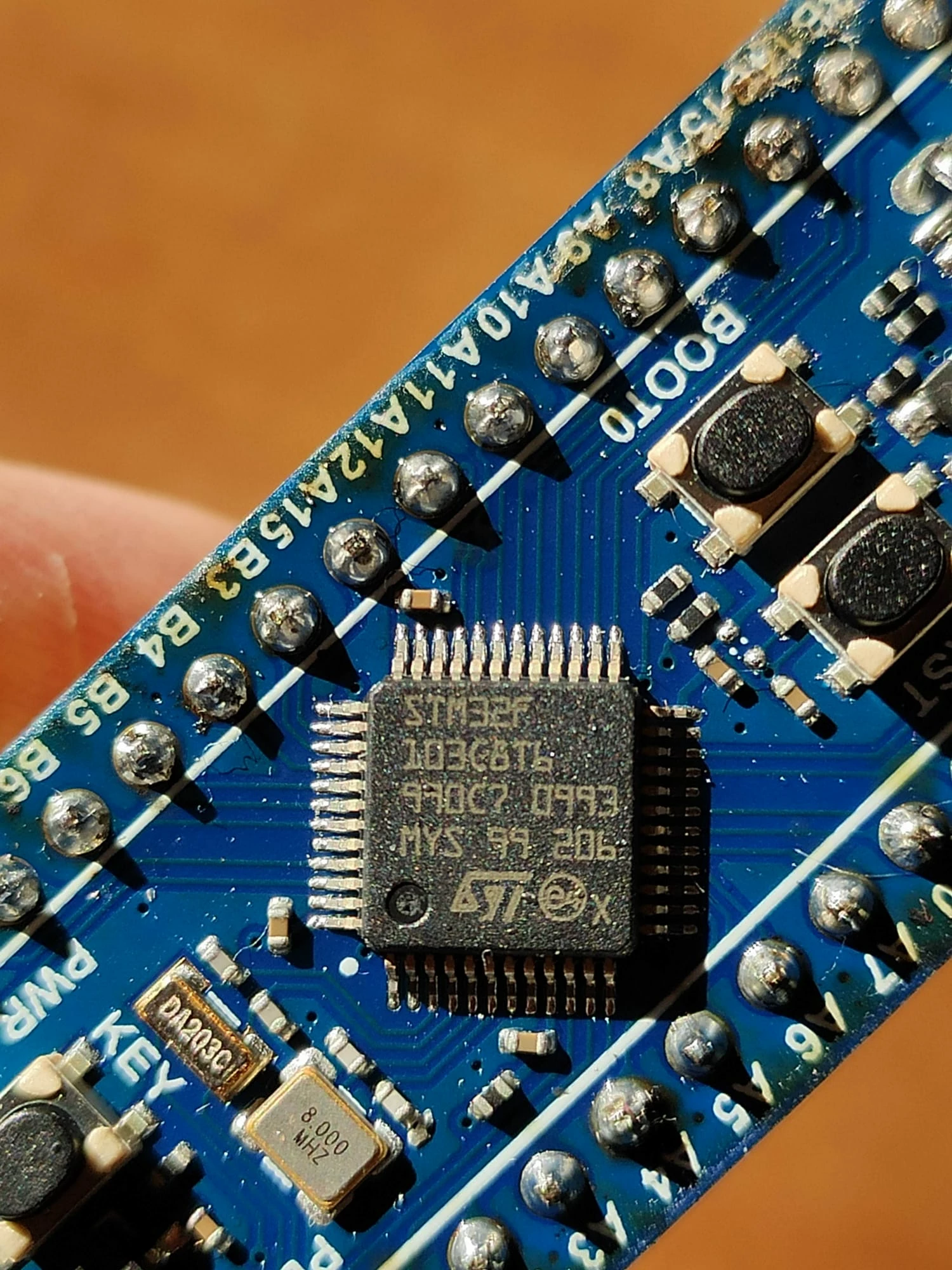

How are you sure it is a genuine ST chip? you can see this link.

@Community member​ : How are you sure it is a genuine ST chip? =>
  • I asked the seller before to buy if the microcontroller was a genuine ST and he answered it was
  • On the microcontroller there is stamped the model and the ST logo (may be you can understand if the char used is an ST one and/or if the ST logo is correct)
  • I had in the past a blue pill board with a non genuine microcontroller (but the microcontroller was not the STM32F103C8T6) and with the ST LINK it does not connect with the STM32CubeIDE while this one connect and correctly debug with STM32CubeIDE
For this reasons, I thought the chip is a genuine one.
Anyway, have you seen my code? is it correct? if it is supposed to be correct and should work, then for sure I have a counterfait microcontroller.
Is there a check (visual or digital) I can do to understand if the chip is genuine? I attach a picture of the microcontroller. Thank you for your support.

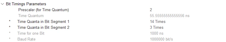

The value 1 is very small for BS1. Try to select a prescaler value as less as possible and BS1 and BS2 values as greater as possible with BS1 > BS2.
Example:

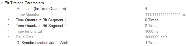

mƎALLEm
Apr 25, 2023 4:53 PM UTC
You can also try this:

The first settings works great!
Thank you very very much!
