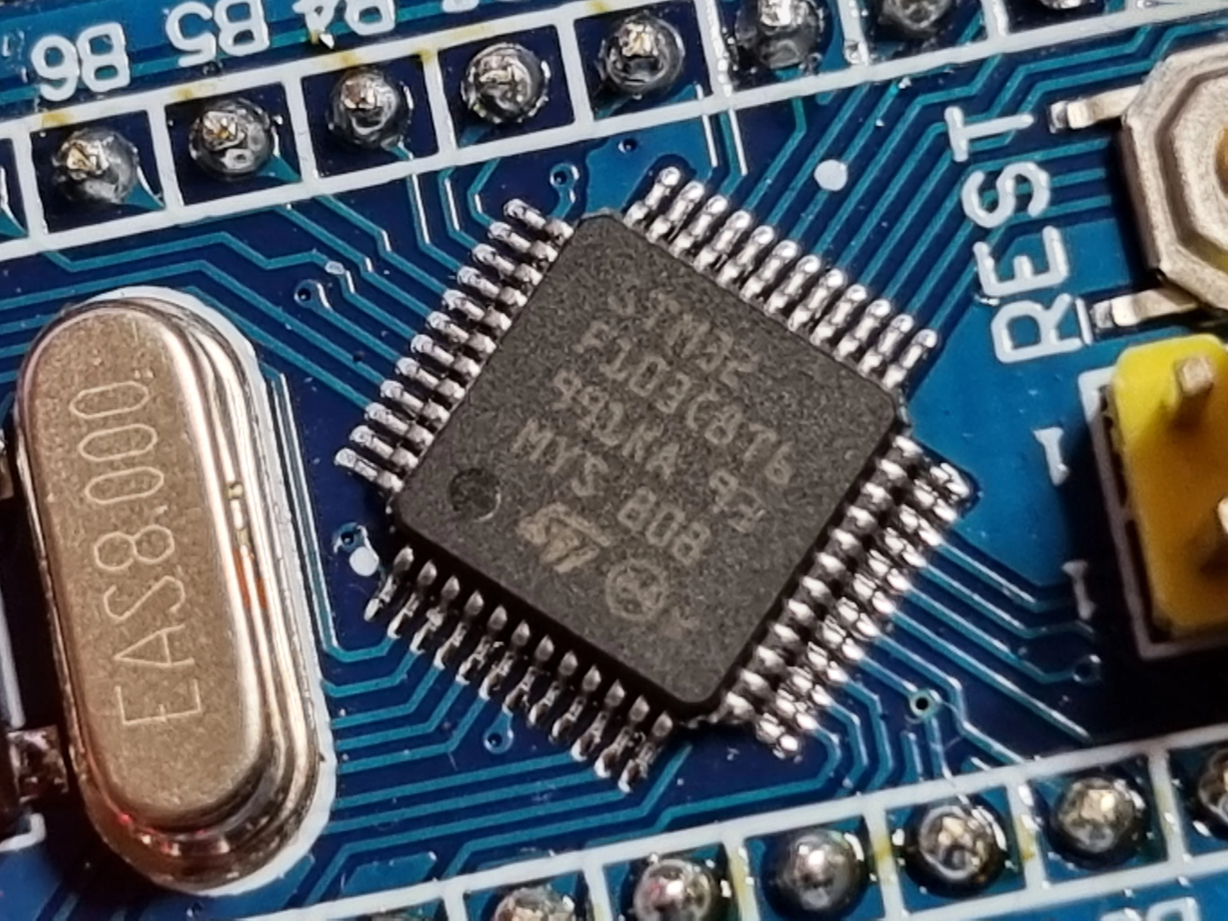

Peter BENSCH
November 10, 2022
STM32F103 Bluepill?
This has been discussed here many times. I would not be surprised if this is also due to the STM32F103 counterfeits that have been used on the Bluepills for a long time, i.e. they are usually not original parts from STMicroelectronics.
There are many websites that have already dealt with this topic, e.g. hackaday.io or eevblog.com.

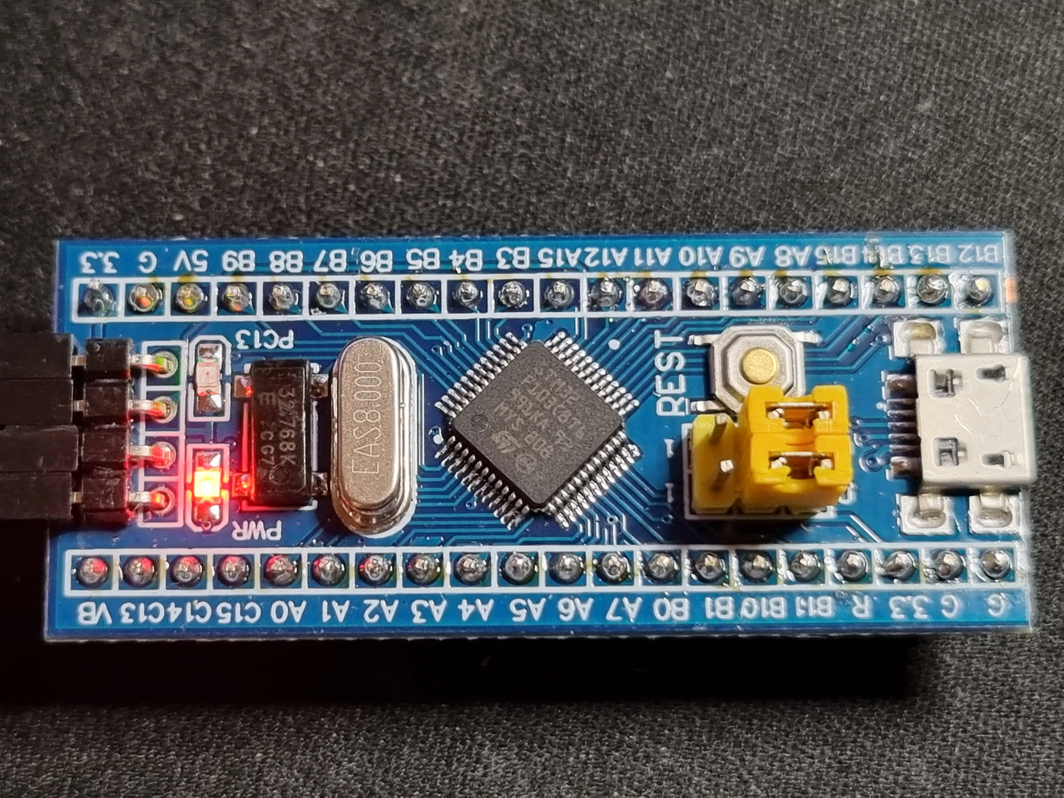

I have heard about counterfeit chips. Never crossed my mind though this time, as I bought the boards from a reputable (?) source in Germany ("Bluepill" Development Board Modul mit ARM Cortex M3 Prozessor – AZ-Delivery).
Would they be selling boards with counterfeit chips?
This is the board I have (I have 3 of them).

At some point I was thinking that maybe there is something wrong with the Transceiver (MCP2551). But I inserted the same chip into another device (using ATMEGA328 with MCP2515 CAN-controller) and everything works perfectly.
Then I am thinking, if I have set the STM32 on CAN Loopback mode, then I don't even need the CAN-transceiver. I then connect the Rx and Tx together (even if that should be done internally) AND I set the Rx to Pull-up, AND I have an external pull-up resistor to 3,3V. But still NOTHNIG! So frustrating!
I set the CAN_Timeout in stm32f1xx_hal_can.c to 1000
#define CAN_TIMEOUT_VALUE 1000U
Did not make any difference, other that the 1 second delay until going to the Error-section.
NikolasZ
NikolasZAuthor
November 11, 2022
I have now ordered 5 genuine chips, that I will use to replace the chips that are on my Bluepill boards. I will see if that will do the trick. Once I know I will let you know.
NikolasZ
NikolasZAuthor
November 11, 2022
Today I tried my code on another Bluepill board that I bought on AliExpress. Ironically everything worked on that board :astonished_face: , so your suspicion that the Boards from AZ-delivery most probably have fake processor-chips, were sadly true. I have contaced AZ-delivery about this, and await their response.
