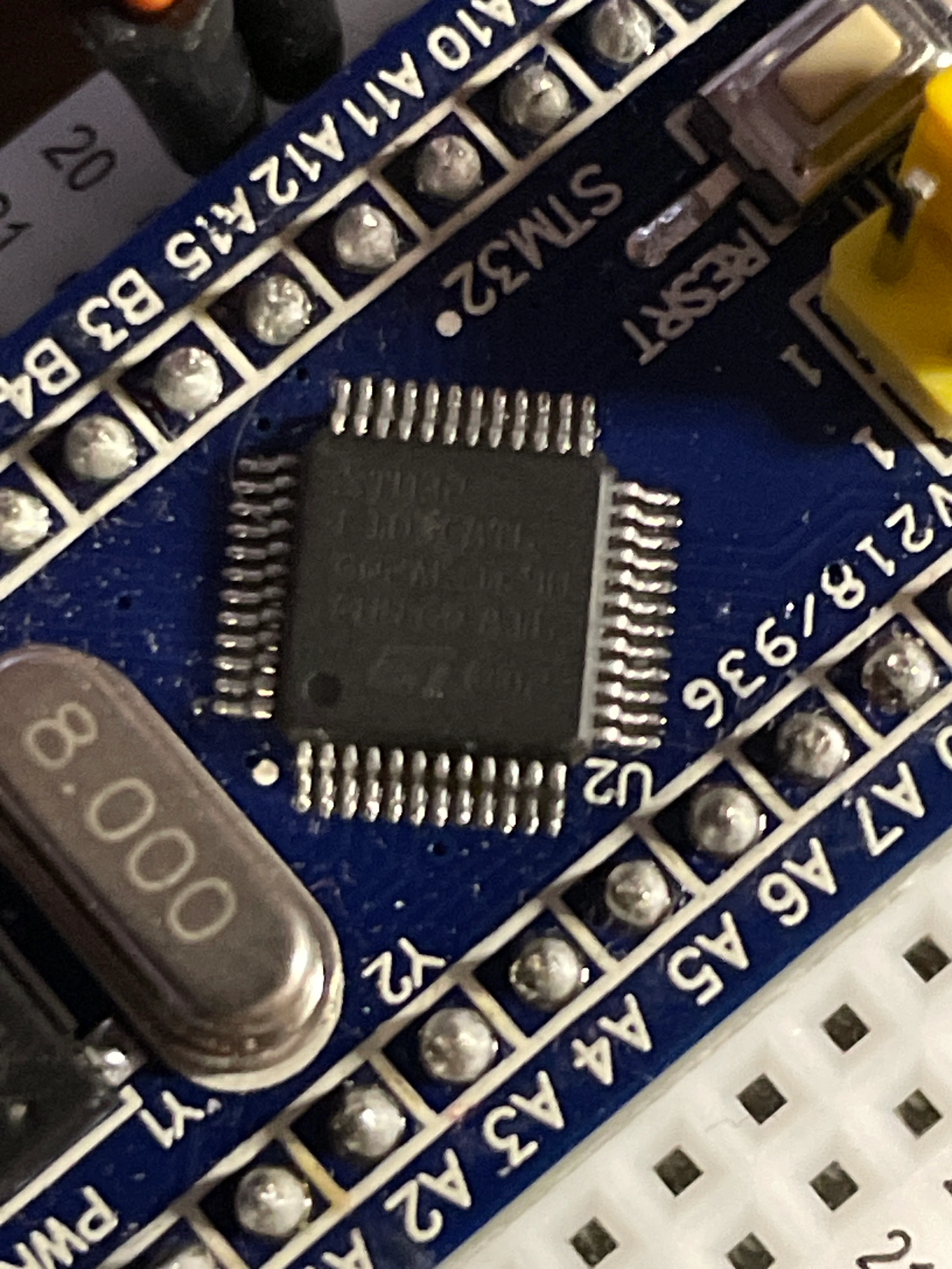

The board has passed a authentication test so I currently believe it is a me issue.
I have been trying to get a CAN bus going using the STM32 Blue Pill board with a TJA1050 CAN Transceiver, but for some reason even with basically copy pasted example code I don't even get activity on the lines. The transceiver modules I am using has the CAN bus terminating resistors built in resulting in a 60ohm resistance between the H and L lines. I've ended up putting together a basic test Tx and Rx bread board in hopes of figuring out whats going on with no clues. The Tx loop eventually goes dead for some reason which makes me think the HAL_addTx started locking up. Linked is a github repository with both projects. Also a video of the boards.

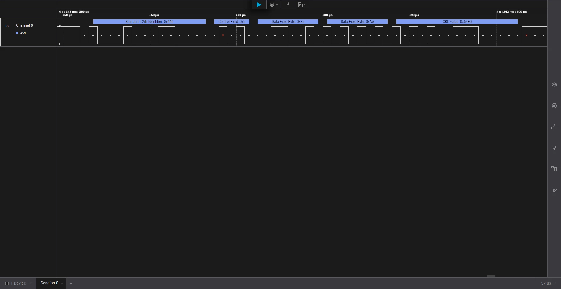

I tried your CAN Tx Test and it seems to be working fine:
I don't think I made any changes, but I attached the project to this message.  Note that I don't have anything connected to the STM32F103C8T6 except for the TJA1050.  I don't even have a 120 Ohm resistor.  I just have the output of the TJA1050 connected directly to the logic analyzer.  I would start there, remove everything and make sure the logic analyzer is showing the data being sent, at least then you know the data is being put out on the wire.

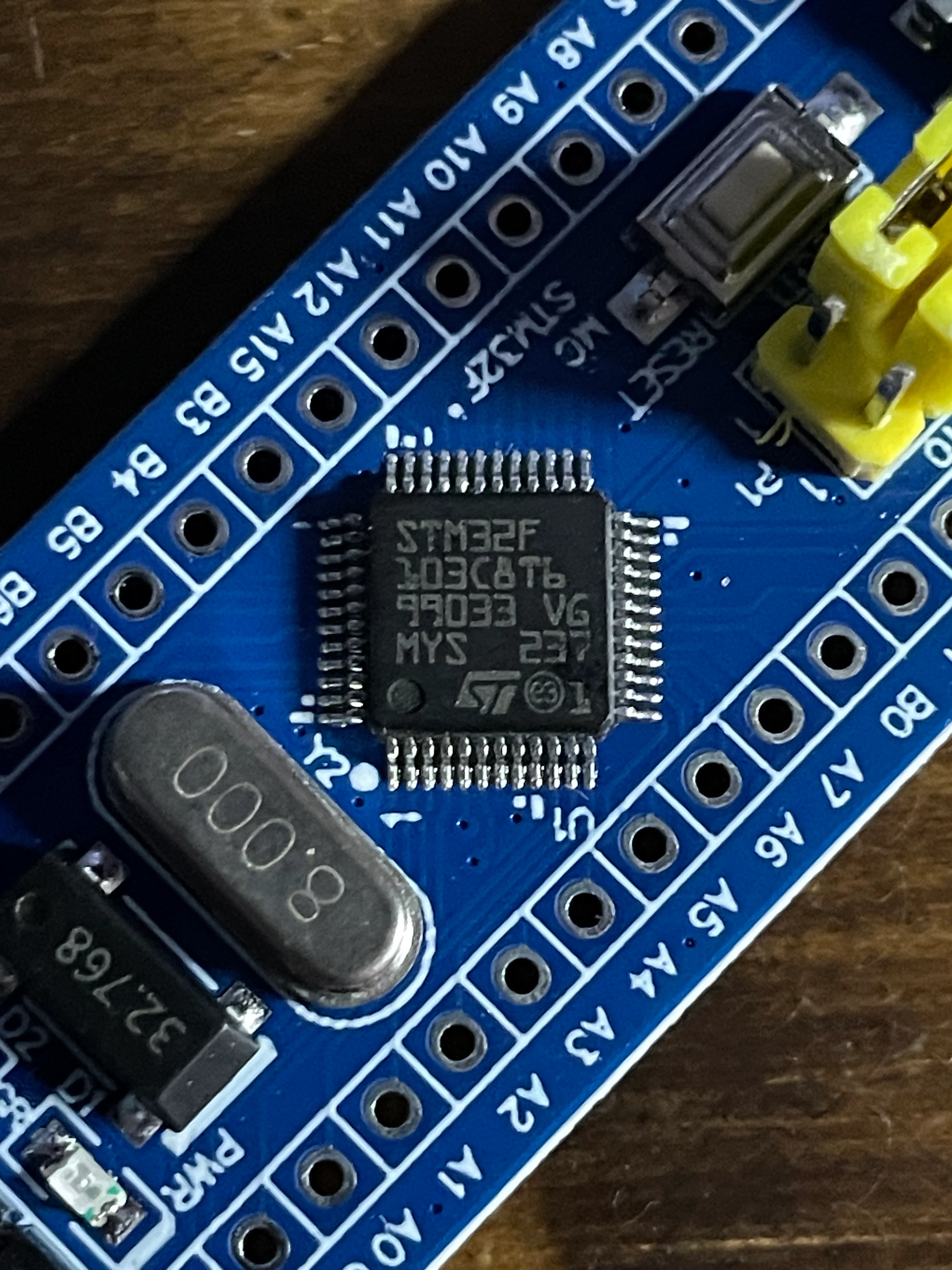

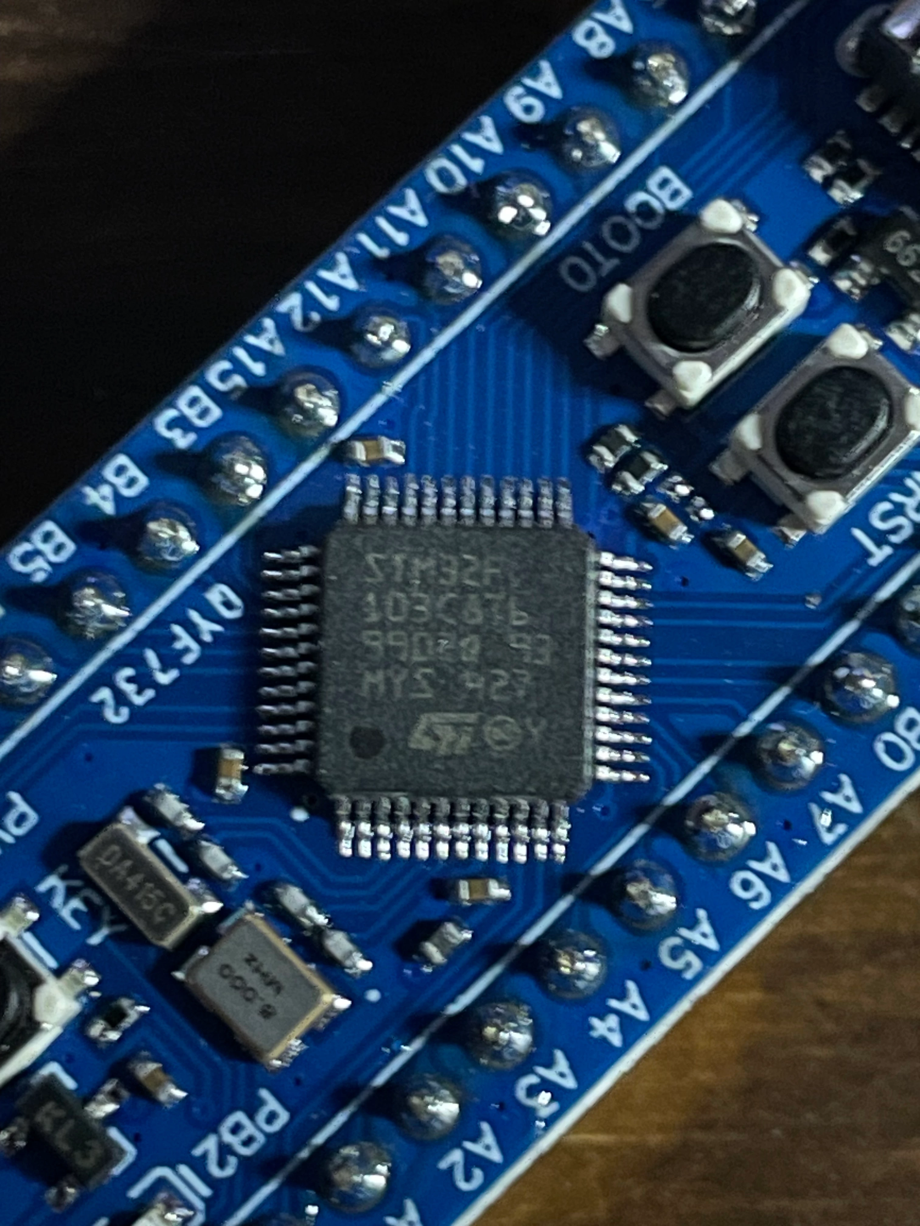

Loopback has worked on at least one board type before. As soon as go into debug mode it runs what seems like half a loop and dies. I got the HiLetGo boards and they do the same. Can I get someone else to test the project on a known genuine board too. I should be getting CANTx data with just the board nothing else but I don't get anything on now 4 board variants. I think I am going to order genuine chips and swap them in. Maybe bluepill diagnostics just made fakes better. I have tried multiple code projects, boards, connections, data analyzer/scopes. I think I am getting nothing but non genuine boards.

Just added Loopback to the Tx Test on GitHub and they seem to be failing. The peripheral is manually set to loopback with mx. There only is one chip that visually seems distinctly authentic. On the HiLetGo board but still it didn’t pass anything. Also in programmer they all show up the same 0x410 and Version X which isn't marked on any chip.

I’ve determined it is not because of non genuine chips. Bought some from mouser and replaced it. Still has the same activity. I plan on setting up CAN on another microcontroller to see if I can determine where my issue is. I may provide a wiring diagram soon.
