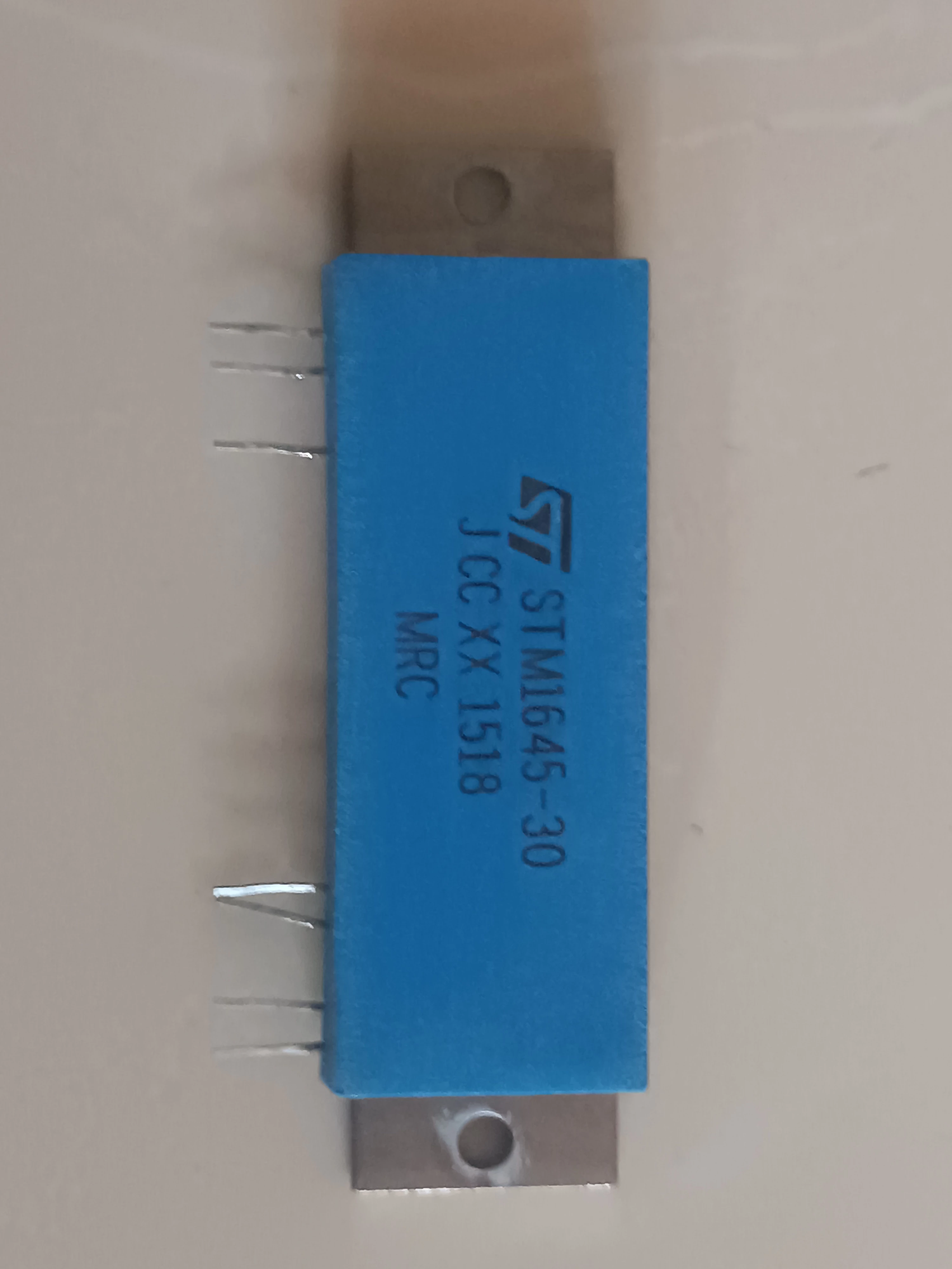

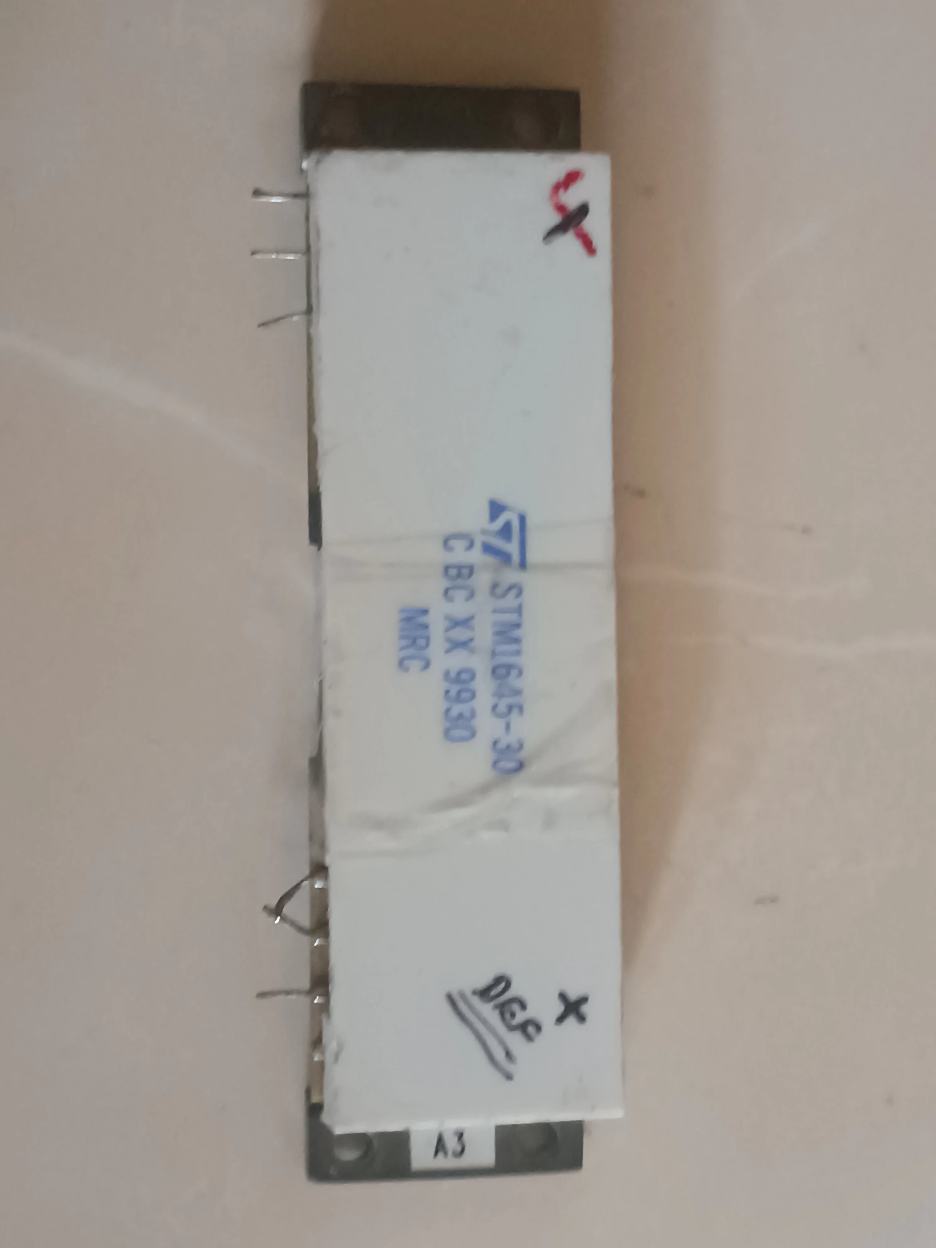

we are trying to replace old STM1645-30 chip with new STM1645-30 but the VCC 28V (VCC and Control Voltage shorted togather) drops .Pleade Refer below
stm1645-30
    Pin    Function
    1    RF Input (50 Ω)
    2    Ground
    3    VC1 — 12 V regulated bias
    4    VC2 — 28 V power supply
    5    VC3 — 28 V power control supply
    6    Ground
    7    RF Output (30 W)
Now the questions:
1.Are the new and old stm1645-30 are equivalent?
2.why 28V is dropiping?
3.in new module pin 4 shows continuity with ground while in old modue it shows about 584 ohms
4.Any suggetion regarding how to test the chip?
