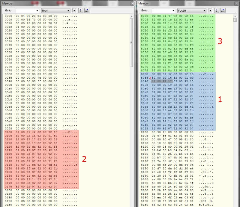

Hi All,
I am during writing bootloader for STLUX processor (base on STM8). Both, bootloader and main program uses own interrupt vector table. The STM8 processor has fixed interrupt vector table at 0x8000 address. I want to redirect from fixed vector table to vector table storing in RAM. I wrote the code to copy vector table from bootloader or main program to RAM and it is work fine, but I have problem with redirection. I do not know how can I do this. I use an IAR. I did an initialization a fixed vector table like this:

The result: 0690X00000602o2QAA.jpg
  1. Vector table from bootloader
  2. Vector table in RAM
  3. STM8 fixed vector table.
As You see, The vector table from bootloader and ram is identical, so it is ok, but the values in fixed vector table are incorrect. I do not know why :(
Any idea? Update: When I manually set fixed vector table (0x8000 to 0x8080) to 0x00 (clear it, green color in above image) I see it is not programming by IDE (all bytes in section are still zero). Of course, I still uses a code attached above. *icf file:
